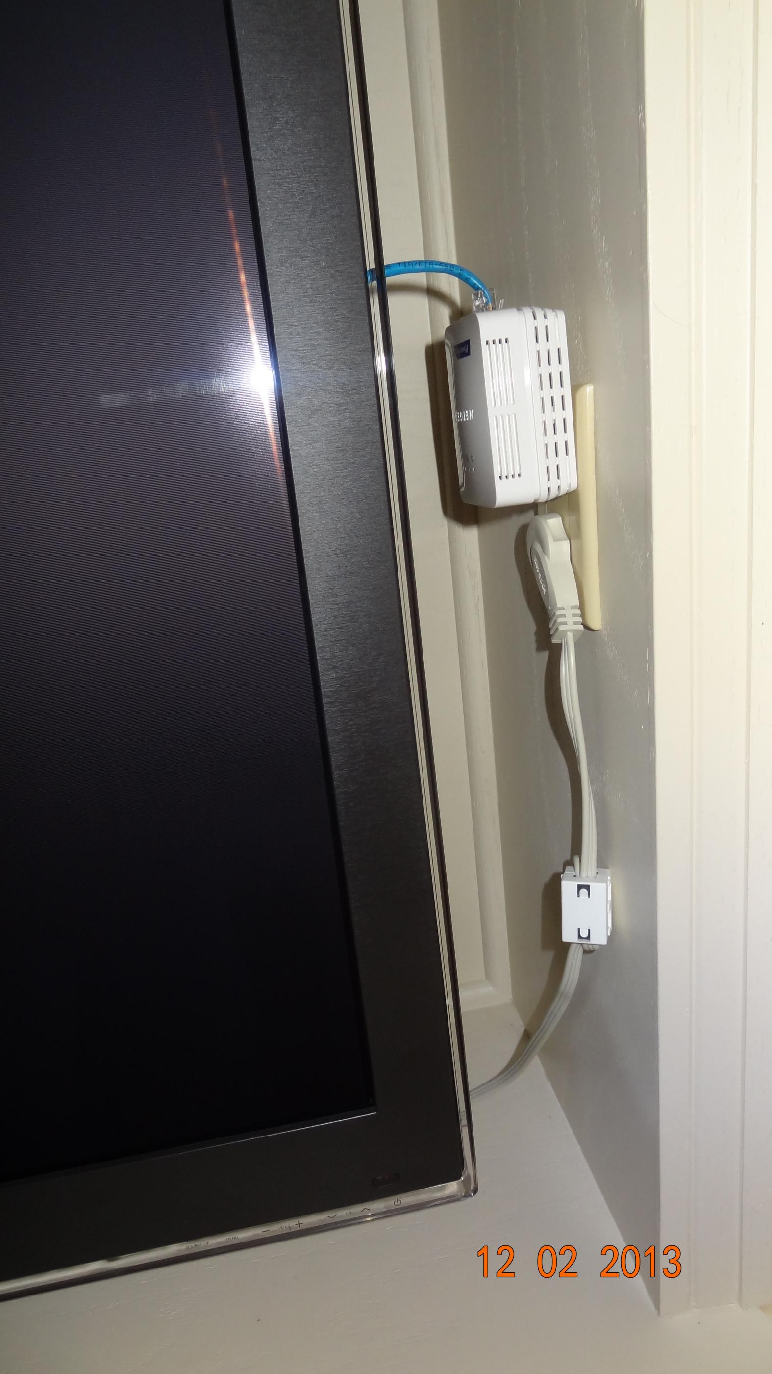

This does work well. Some HF/Rf signals are on the ac line that are wanted --- Power Line Communications (PLC) is popular for streaming video from room to room without rewiring the building. However, you dont want it in your computer, video and digital and video etc. I use the ferrites to do two things on my PLC shared ac power wires: Place a ferrite of the proper type for the PLC freq's on everything else. This also keeps the PLC signal strength at it highest for distance and quality/speed. parallel equipment on the ac line attenuates the PLC signal. And, conversly you dont want all the junk put on the ac pwr lines by your electronics to interfer with the PLC signal. I use them for selective isolation between wanted and unwanted.
See attachment;
I use a ferrite readily avail at a local electronics, A-V chain store called FRY's Electronics in Calif. Look for them under the System Cabling Accessories as noise filters.
BTW -- the speed and operation with the ferrites on everything was measurably increased after their application. In my case almost doubled the PLC data speed. I use the PLC for streaming HD video in real time while watching the movie (Netflix). And, i use PLC to access and select music files on remote server in another room for music playback.
Note too -- power line filters will remove the PLC signal. Only certain Monster ac line filtering has unique circuitry to prevent this on dedicated outlets for PLC use while filtering all other freqs. [not a commercial - just a fact]
Thx-RNMarsh

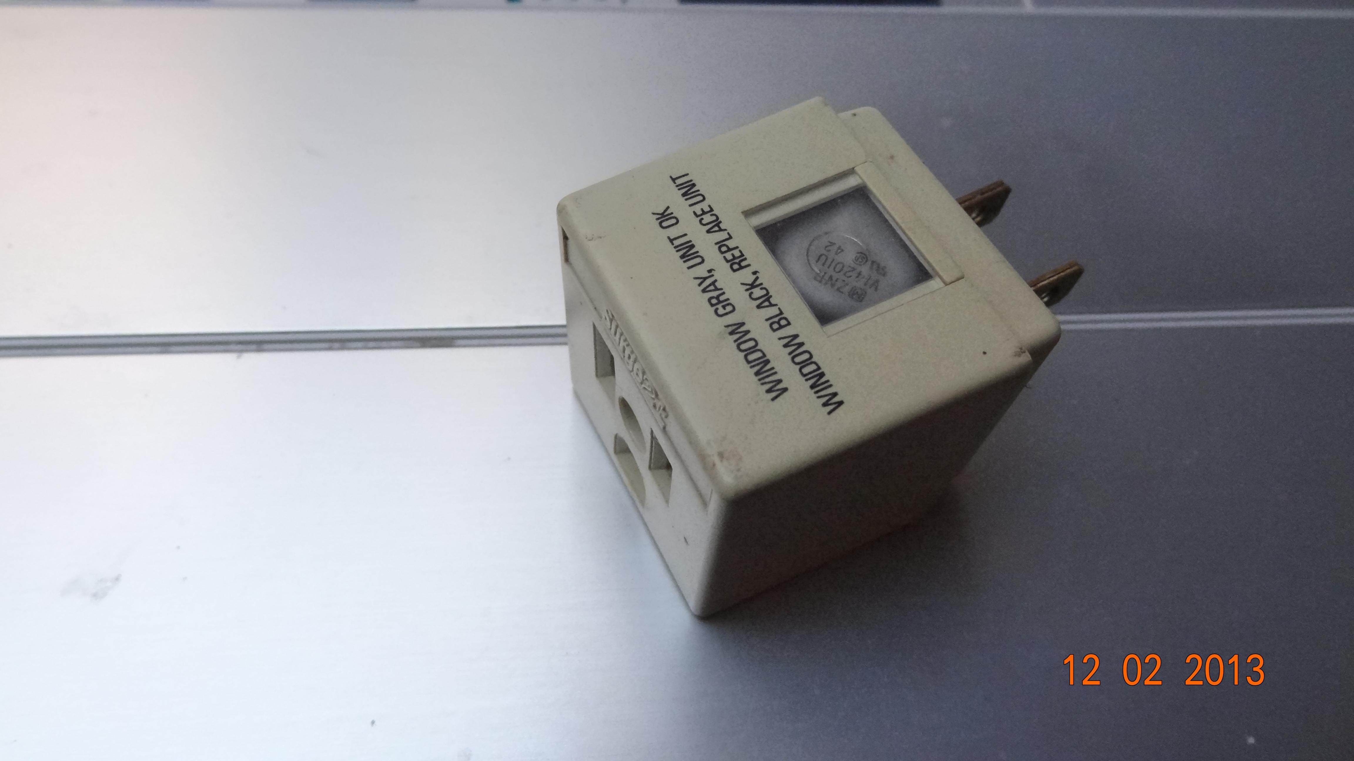

HF/RF from PLC does not travel long distances on ac power wires as their series inductance is just too high.. too lossy. It doesnt get to your nearby neighbors -- maybe in an apartment, yes. However, for PLC to get approval... it cant go far enough to interfer with neighbors.... via conducted mode nor as radiated (anetnna) from the ac wires.... [ditto WiFi in homes etc.] So that has been addressed at the design level.
However. having said that, you can do what i do -- locate your Service Entrance panel (circuit breaker box). On the oppose wall, inside... often a garage ... there will be a utility outlet which is closest to the Panel. Plug in a surge protector right there.... it will catch any transients on the line at the earliest point of entry into the home. An MOV is fine as it also has enough capacitance to do some RF filtering across the line all the time... paralleled MOV would do better in regard to RFI in/out thru the Service Entrance panel. [you could this on other branches as well]
Enjoy!
-RNMarsh
However. having said that, you can do what i do -- locate your Service Entrance panel (circuit breaker box). On the oppose wall, inside... often a garage ... there will be a utility outlet which is closest to the Panel. Plug in a surge protector right there.... it will catch any transients on the line at the earliest point of entry into the home. An MOV is fine as it also has enough capacitance to do some RF filtering across the line all the time... paralleled MOV would do better in regard to RFI in/out thru the Service Entrance panel. [you could do this on other branches as well]
Enjoy!
-RNMarsh
Something like this might help in several ways --
