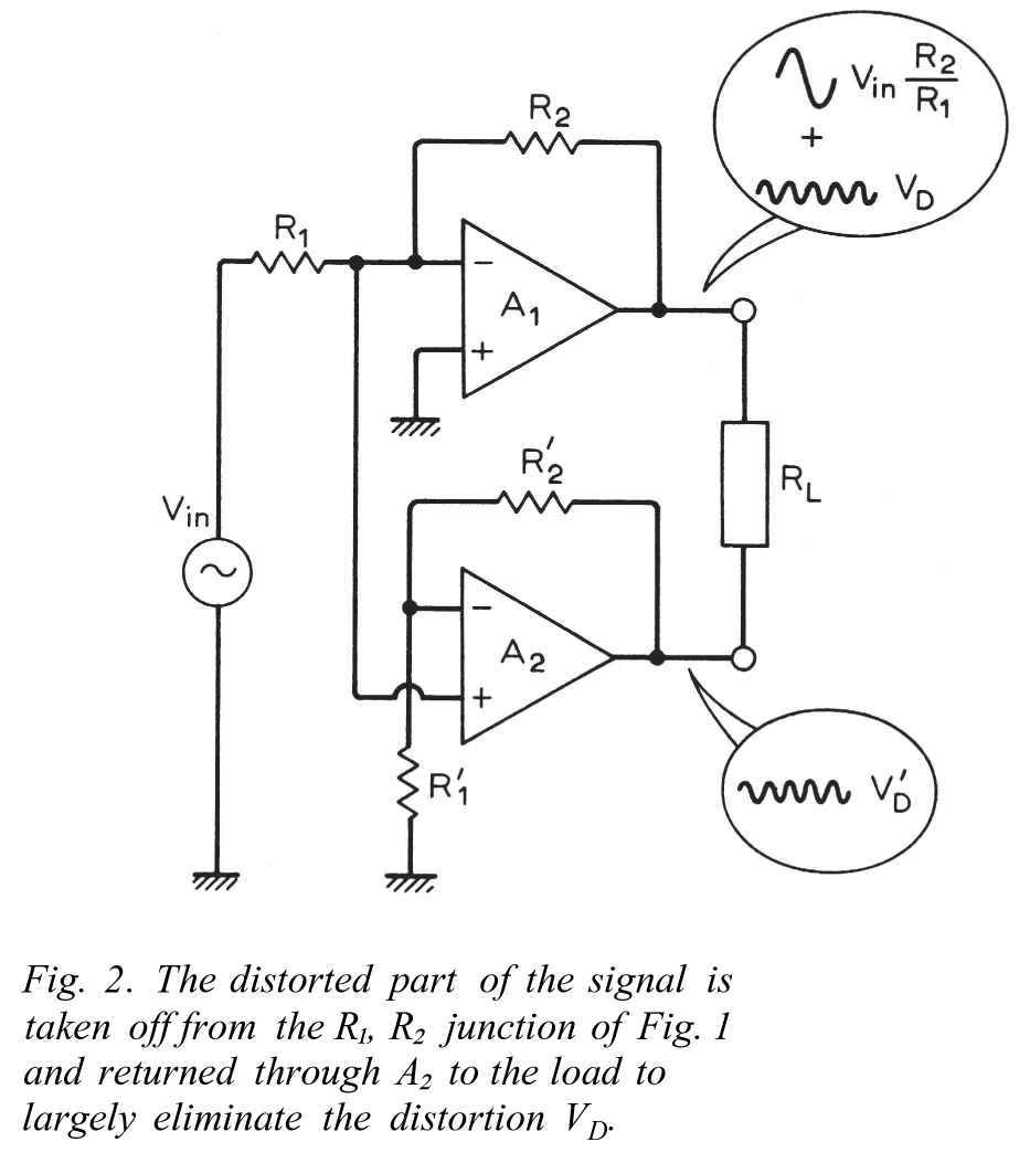

The lower amp is amplifying the error of the upper one (and contributing a teensy bit of its own distortion). Then the net output signal is the difference of the two opamp outputs. The output signal of the lower amp is small.Richard, i don't understand the first schematic: the signal at the - input of the upper OPA will be very low and contain lot of distortion. So it is a matter to sum the two ( non symmetrical ) outputs ?
Of course the device(s) that do the latter differencing are critical, so the overall system performance needs to be evaluated from that perspective.

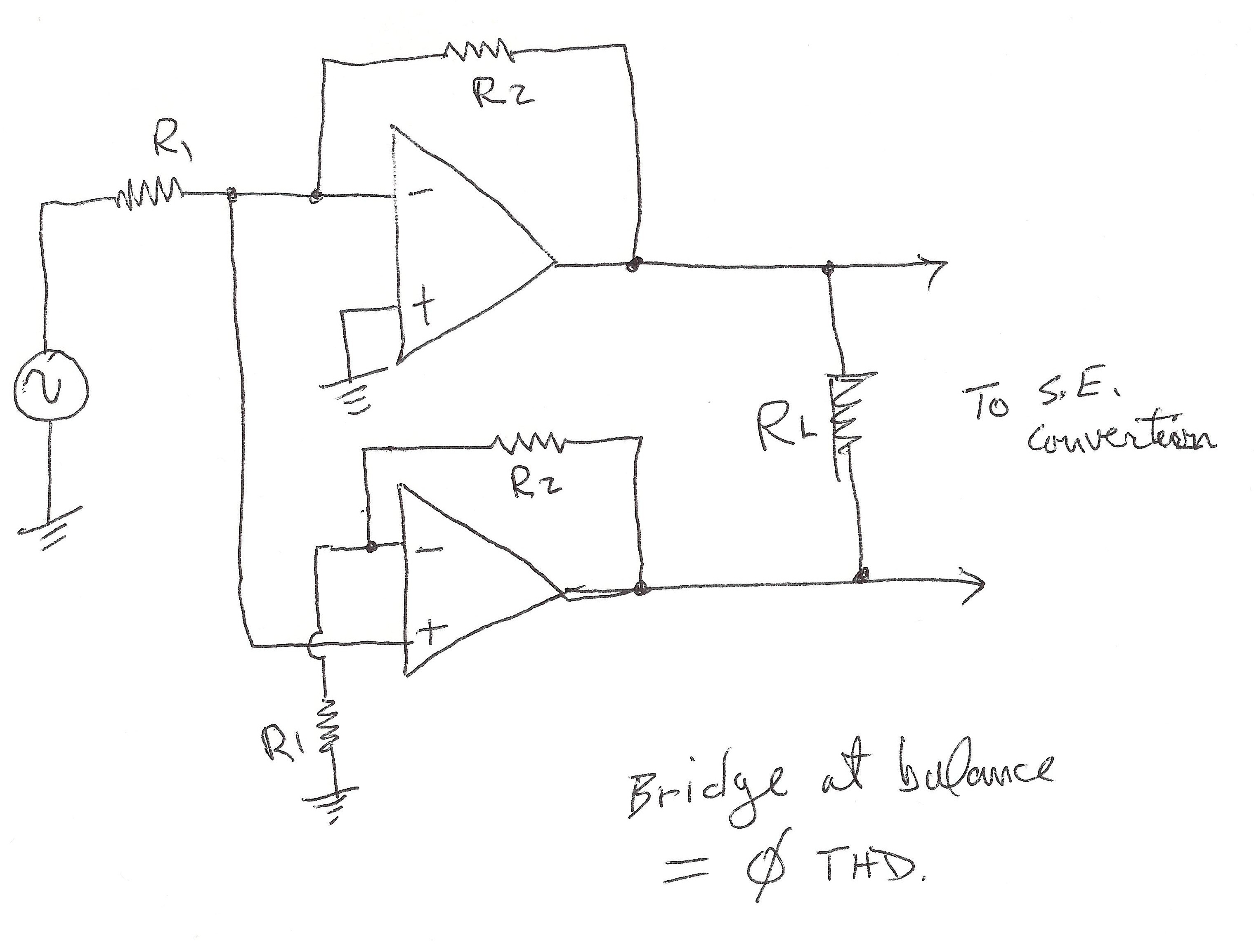

First schematic is a balanced bridge arrangement. Yes, distortion sums in Rload.
Trim R values as needed to get null --- will progressively cancel (sum of + and - error) for lower and lower levels of thd.
Error take-off for thd reduction does not depend on gnfb and its falling open loop gain issues (stability, gain/phase, reduced nfb at high freq, increasing thd vs freq etal).
I'd like to see more alternate ideas tried and optimized.... See what it can do... pro and cons.... 'cause its getting boring with just gnfb to talk about. Good place to use SIM ?

Another amp for what ever -->
balance the bridge circuit and get zero thd.
Use error take-off and bypass the gnfb issue of lower fb at higher freqs.

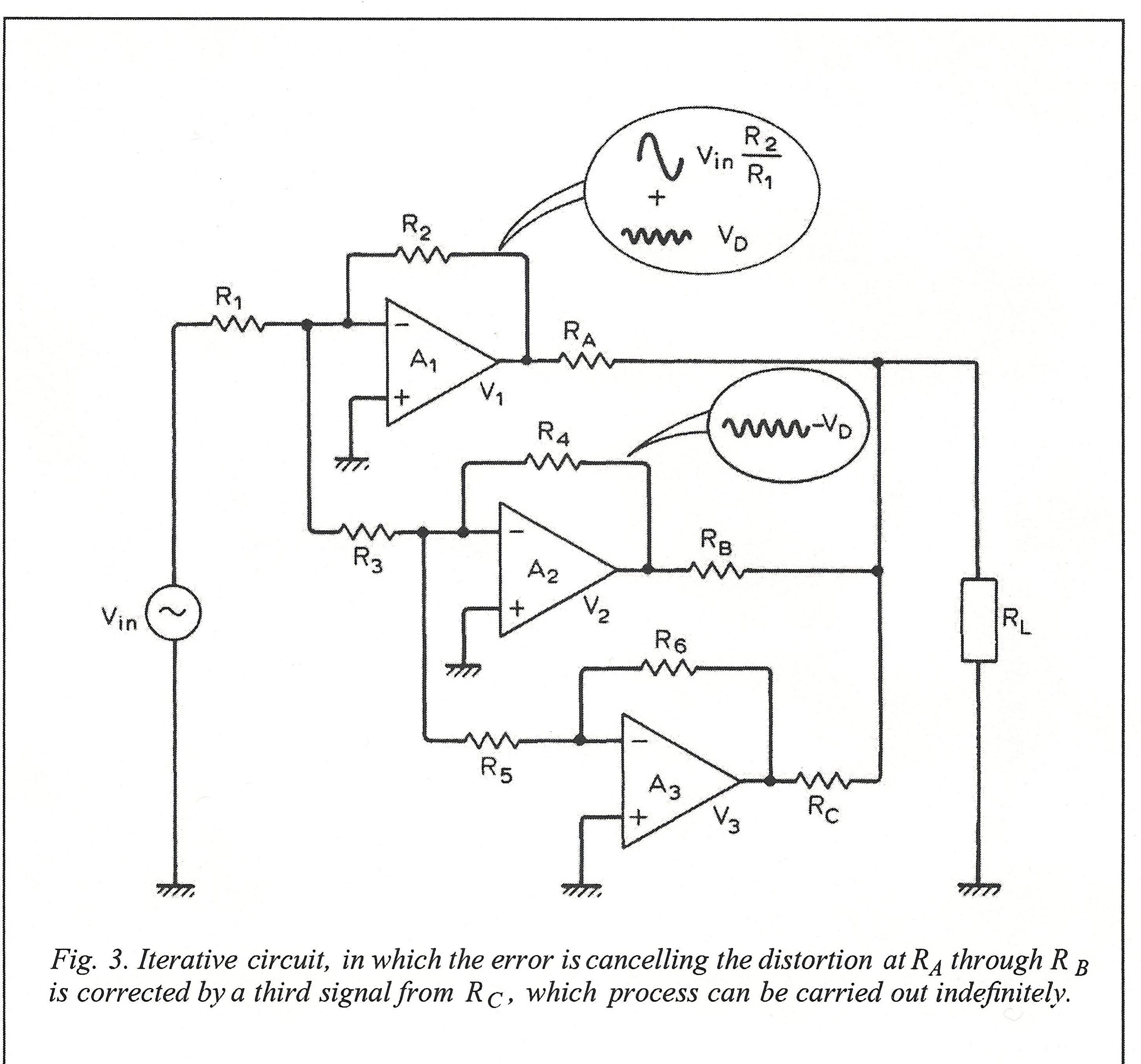

The second attachment is from this article:
http://www.keith-snook.info/Wireless-World-Stuff/Wireless-World-1974/Reducing%20Amplifier%20Distortion%20-%20Sandman.pdf

Sandman's article has a Fig. 2 which the old guys might recognize as the
basis for Mike Wright's ill-fated XEC1000 power amplifier. The idea was to
use a smaller amplifier correcting the larger one. The problem of course is
that the smaller one had to deal with the large load current....

Boy you are good! That was fast, too. yes, Sandman in Wireless World discloses this error-take off approach and gives some back ground to Black (Mr neg feedback). It is Sandmans own original idea. Wireless World 1974.
I think it has great potential. Maybe with power amps? They still need a lot of help. Or low thd oscillators... the concept can be used somewhere to advantage. It seems to have been under-developed.... Is this what Walker/Quad amps were inspired by? Thx-RNMarsh
I think that's called Hawksford error correction, but there's *always* priors in electronics. Usually Blumlein or Baxandall!

No, that is a comparitor between I/O, etc. Sandman shows something different in functionality. Inverting the error signal and feeding it into the output (inverted) to cancel thd. Thx-RNMarsh
Chris, Richard is right. It is not Hawksford.
Yes there are priors, which AKSA highlighted after I originally posted it up a few months ago. However, as far as I can tell, it's never hit the mainstream.
