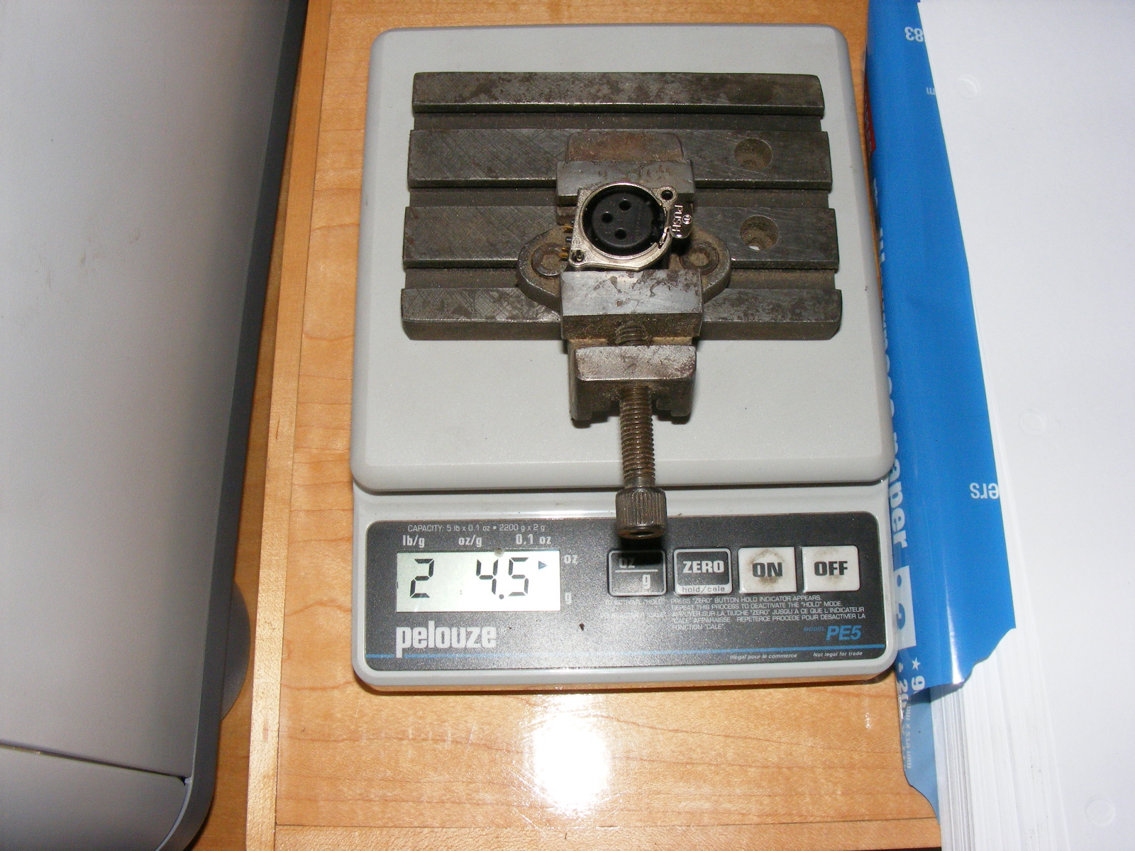

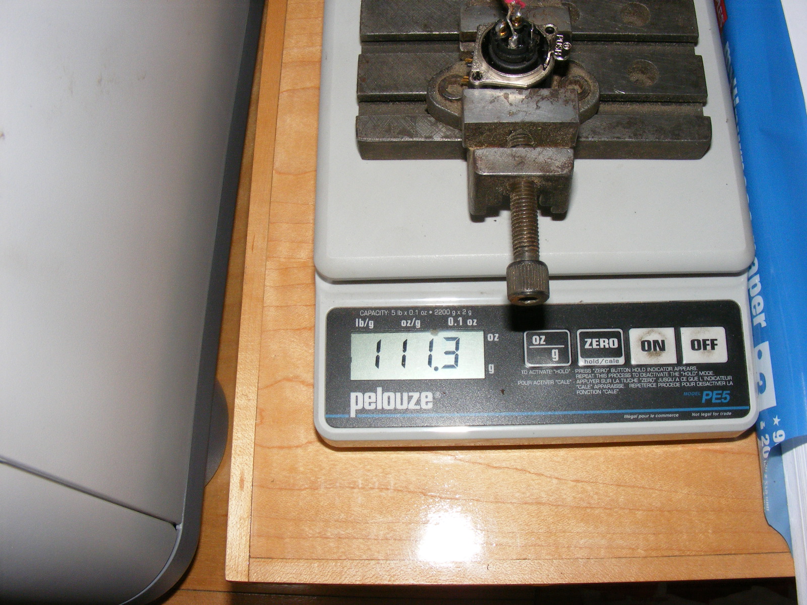

Now let's see, SY reports his boss has a problem with XLR connectors falling out of their sockets when horizontally mounted. The XLR connector does not have a latch.
So I decided to do a simple test. I used one of the forked contact female connectors and a male insert only. No outer shell.
The photographs show the weight of the small vise and the connector and then the weight just before the connector slipped out.
36.5 oz vise and connector weight - 27.3 oz at pull out = 9.2 oz of holding strength.
So even without any shell what kind of cable has that much straight pull?
