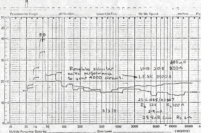

I attach 1/3 8ve noise plots of a good MM system c/f probably the quietest MC preamp in the known universe in practice.
Here's a 1/3 8ve noise plot. The B&K 2307 chart recorder has slipped by 1 tooth so 50Hz (hum) appears at 40Hz. 1dB/division
The MM is an Ortofon VMS20E. The Ortofon MC, either MC20-2 or MC10. The MC preamp is set for very high gain 28.8dB so if adjusted for equal loudness from the 2 cartridges, the noise advantage of my little circuit is even better.
What this shows is that with the common noise weightings, the MC with this circuit is at least 3dB better than the MM into a good MM RIAA preamp. But the character of the noise is nicer too. With RIAA, MM noise is whitish while MC is redder than pink and less obtrusive.

Scott, is that the one where they use a MM example and work out noise in 1/3 8ve bands? I'd appreciate a ref. I've been trying to find it since 2008.
