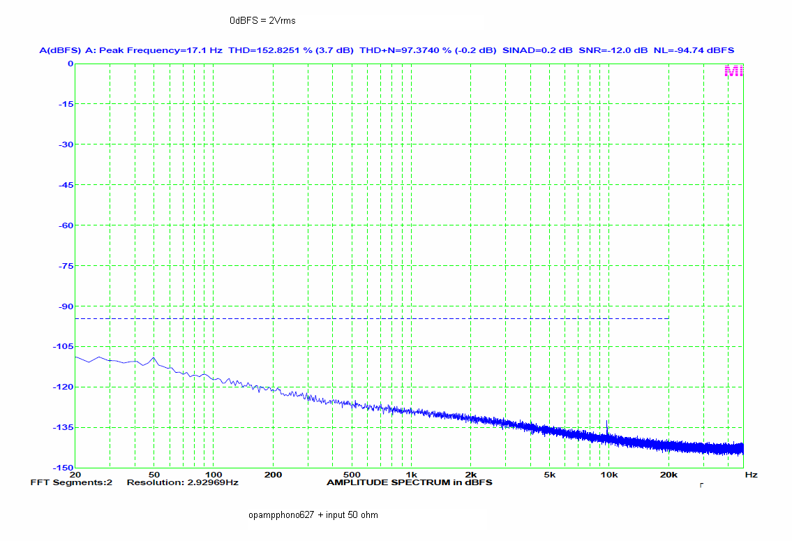

I wish we could persuade JA/Stereophile to measure phono noise with the input open, as well as what they do now (input shorted), and then back out the current noise contribution based on various cartridge loads. MM applications in particular, given their high inductances, will be affected significantly.
JC's (and some others') JFET-based preamps have low current noise, as well as very low voltage noise. Most op amp-based designs have high current noise, unless they are JFET input, in which case they usually have rather higher voltage noise.
I agree that the measurement with input shorted is telling not much for MM preamps. I measure the noise with input shorted and also with input connected to the real cartridge. Above 2 or 3kHz we may see a contribution of the 47k loading resistor. I would also appreciate if JA used log frequency scale. Lin scale masks eventual poor supply line induced noise rejection.
Gain of the measured preamp is 40dB/1kHz.

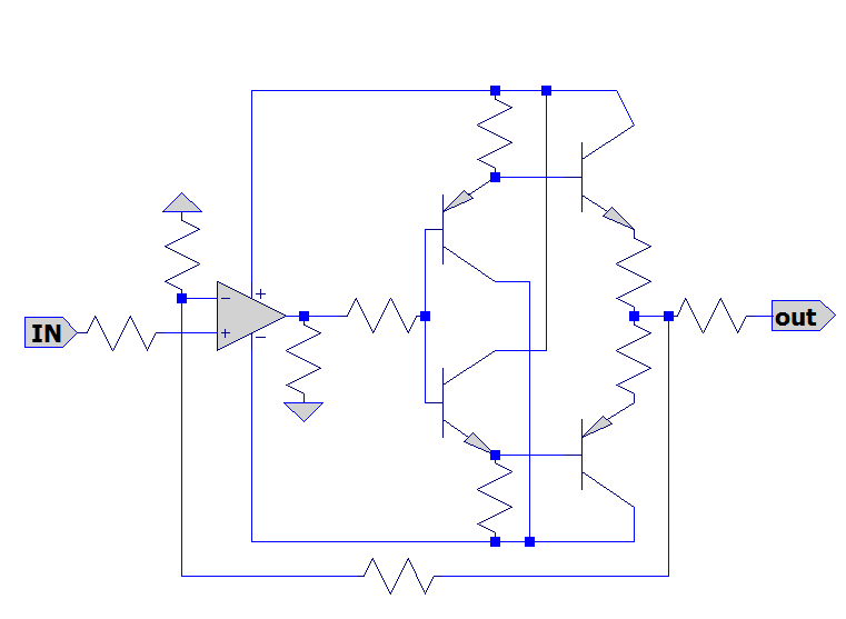

I will go for 4Just place a 3 transistor discrete buffer on the output of the op-amp inside the feedback loop.
I don't understand the john's problem. Or you need low noise at low levels, and you can set the resistances value low, or you need output buffer, and you don't care about the resistance's noise and/or you can add a buffer as in this schematic.
