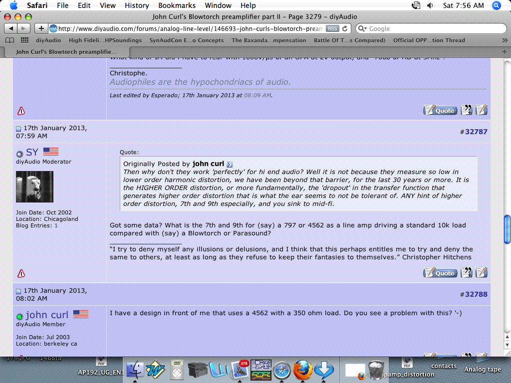

The problem is that John explicitly said that competitive preamps using IC opamps were "mid-fi" because of higher 7th and 9th harmonic levels compared to the equipment that his "team" designs. That is an objective, numbers-based claim.
Maybe it's just me and my silly stiff-necked sense of honesty, but if I claimed a performance shortfall for products which competed with mine, I'd have data to back it up or be willing to retract my claim. The fashion audio world is apparently different...

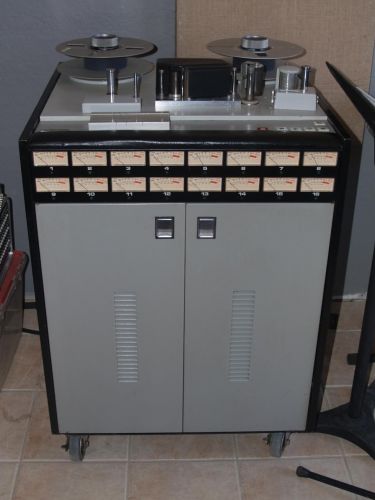

I was exposed to it for many years with analog tape recording, in which the 3'rd harmonic (totally dominant because of the tape itself) could be reliably predicted, over and over, with different recording levels, once a single distortion with level was measured.
I am VERY surprised to read that under your pen John. When we arrive near the saturation of the tape, the response curve begin to change. ~0dB is the max level you can achieve at 10hHz and 15 Ips, right ? While you have more than 10dB more available under. So the harmonic distortion is not linear at all, and the higher harmonics decrease, there, where the level increase.
It explain the "hot" sound with tape on hight transients.
I used sometimes, to clip the kick drum, and record-it that way on tape at VERY high level: Tape's saturation removed all the high harmonics, and gave a very natural 'kick' attack, even when the original sound was dull and just resonant with not enough transient. You were not able to hear distortion, just what you believe is the hit of the beater on the skin, while the sound from the desk was awfully saturated.
Very little between 15 and 30 ips ....
Reason why 15 Ips was chosen as the standart professional speed for tape recording.

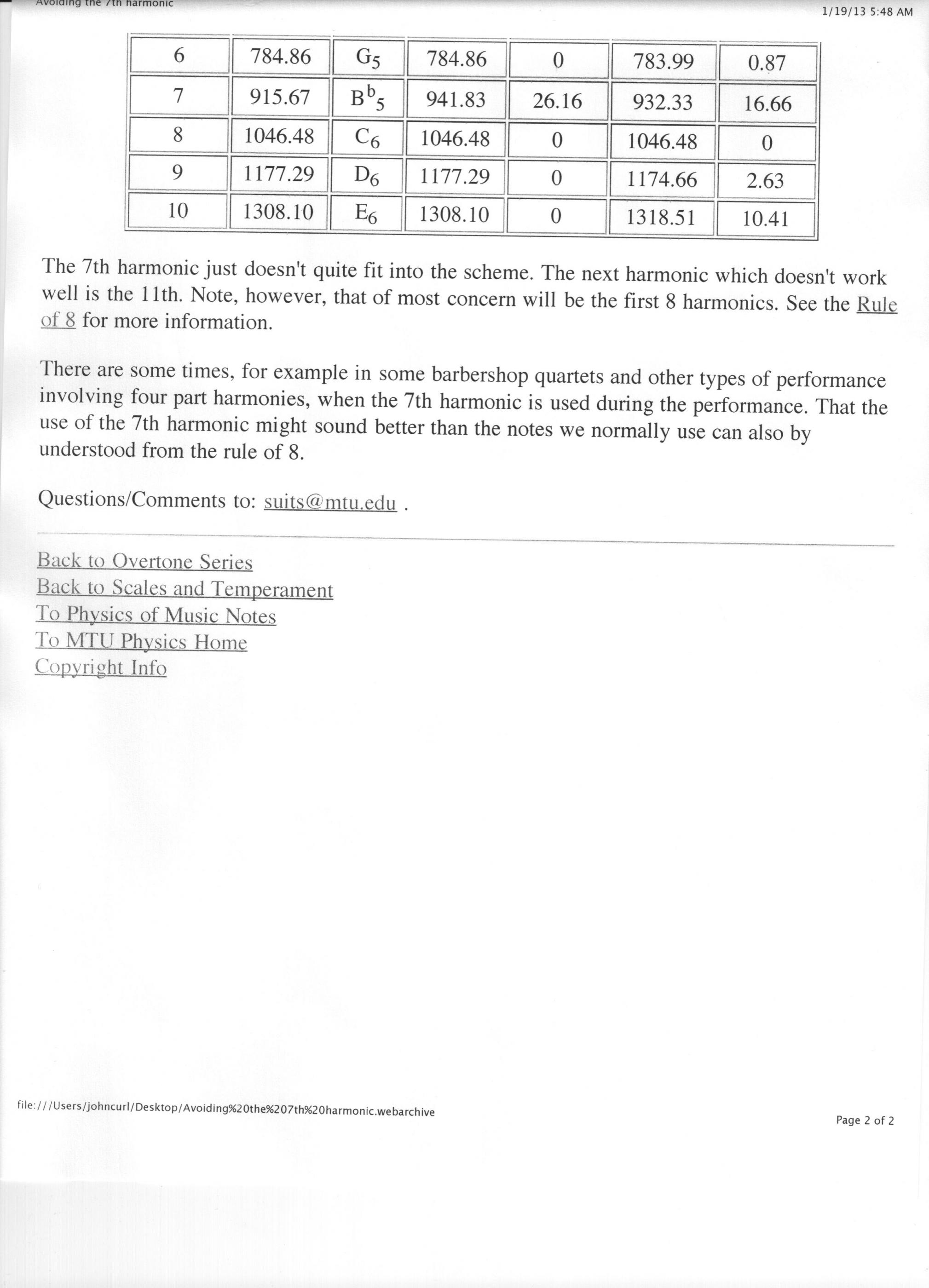

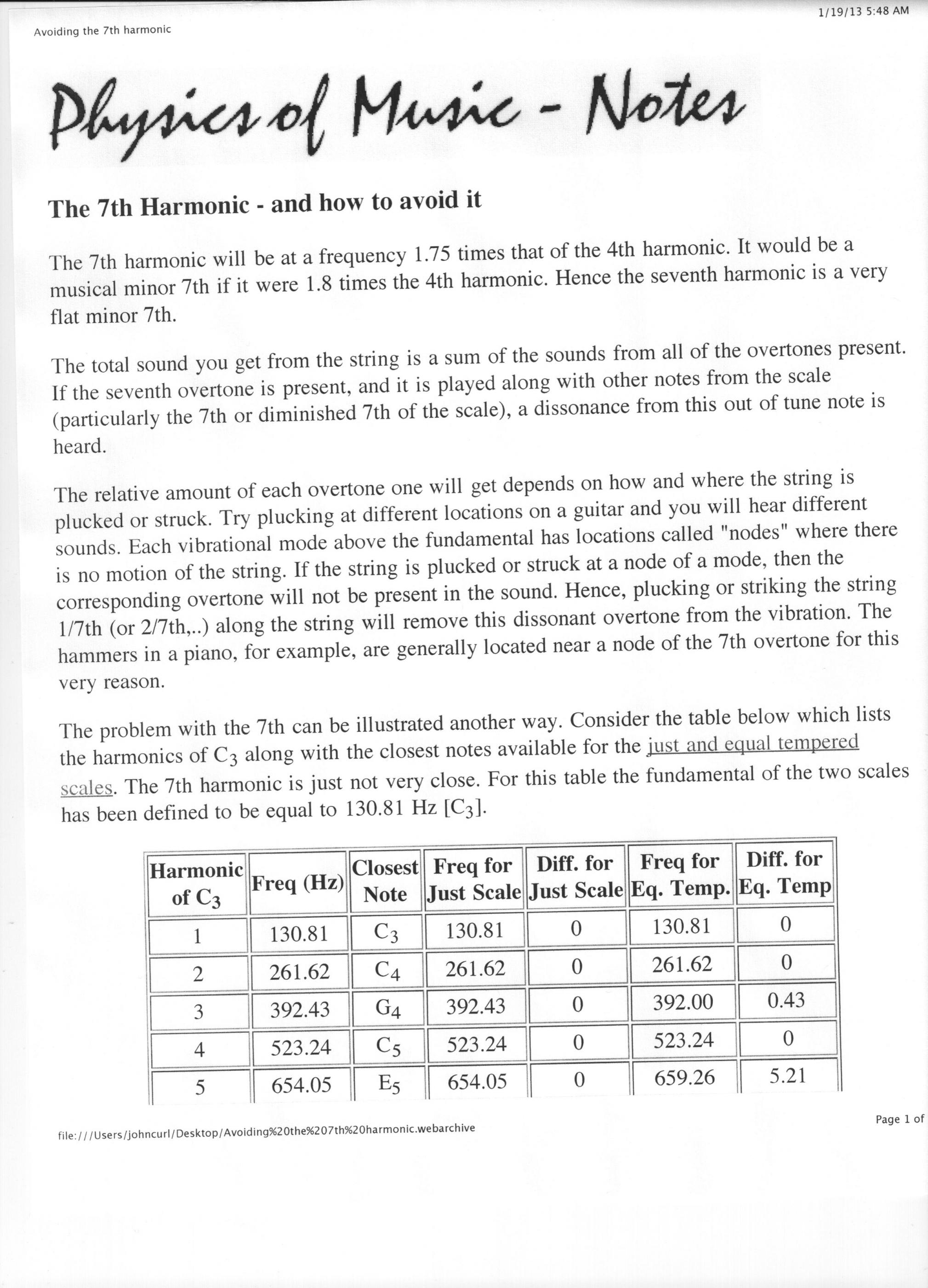

First, let's address 7th harmonic. Here is a small article on the subject. I didn't invent the problem, just noted it. It took me less than 5 minutes to find it with 'Google'.

OK, I am going to have to 'pull rank' Esperado.
I actually DESIGN analog tape recorder electronics, and I have the experience.
To see this effect easily, you HAVE to measure the 3rd harmonic with some sort of analyzer, the clearest in this case being a WAVE-ANALYZER, as you can tune to just the 3rd, as you go up and down in level measuring a tape as it is being recorded and reproduced. You will find that my assumption is very accurate up to about 10dB above Ampex operating level of 185nW/m or 0 Vu on many machines, including my own, to about 30 dB below 0Vu. This is the range that we normally record material with analog tape.
Many here have never used or worked with a really fast, clean recorder, so your results may vary. For example, lower speeds require a SIGNIFICANT amount of treble boost to make up for tape thickness losses, to the point of extra distortion added at virtually all mid and high frequencies.
Of course the tape SATURATES, and this brings out 5th and even 7th harmonic distortion, at levels above 20dB above 0 Vu as set above, but I found, early on, that it is usually the tape recorder electronics that contributes most of it, due to sloppy design. More headroom was necessary, and I put in at least 6dB more headroom in my own tape recorder electronics, so that tape limiting would be lower order as much as possible.
You're barking up the wrong tree John. Nobody disputes that 7th sound bad.
What is disputed is that you seem to be able to hear it at -10zilliondB even from 5 miles out 😉
jan

So... what about that mid-fi 7th and 9th which separates IC based preamps from true "high end"? Got the data yet or was that also made up?
I mean exactly what I wrote. The vast majority of power amps (yours included) have input impedances of 10k or higher- not 350 or 600 ohms. Configure a good IC as a line stage, drive to the same voltage levels you cited for the BT into a 10k load, and what's the 7th and 9th? For the appropriate choice of feedback components (for argument's sake, choose the same gain as the BT line stage), what's the S/N referenced to the drive voltages you used to illustrate the BT? How does that compare to the S/N for the BT? (Hint: using your asserted power law, I already showed that a 797 will have 7th and 9th at better than -200dB even with a 600 ohm load and configured in a distortion multiplier circuit)
Got that 7th and 9th harmonic data yet?
