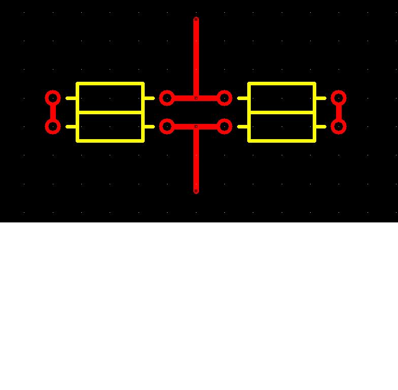

JN Should we talk about PC layouts that minimize inductance but allow for uniform heating? I like eight resistors, two on the top right, two on the bottom right, the other four same on the left. Resistors parallel to each other. Signal comes in splits to 4 goes through and then the other end is connected to the paired one and returns back the way it came.
Attached is a top view, same on the bottom but staggered so the pads don't touch.
ES
Don't forget, all the heat comes out of the leads for resistors. Standing them on end with a daughter board at the top of the resistors allows the interleaved pattern, as well as allowing the pc board artwork be used to conect half going up, half coming back. A trivial way to create my sub nano zero B dot resistors, and the best part is increasing the dissipation by design decreases the inductance, and the top board can also be heatsunk free air.
I'd recommend using this structure to create the feedback divider needed for most power amps.
The resistor design you're trying to make was created back in the late 80's if I remember correctly. It was a non inductive attempt for a TRR tester back in the day. I'll try to dig it up.
