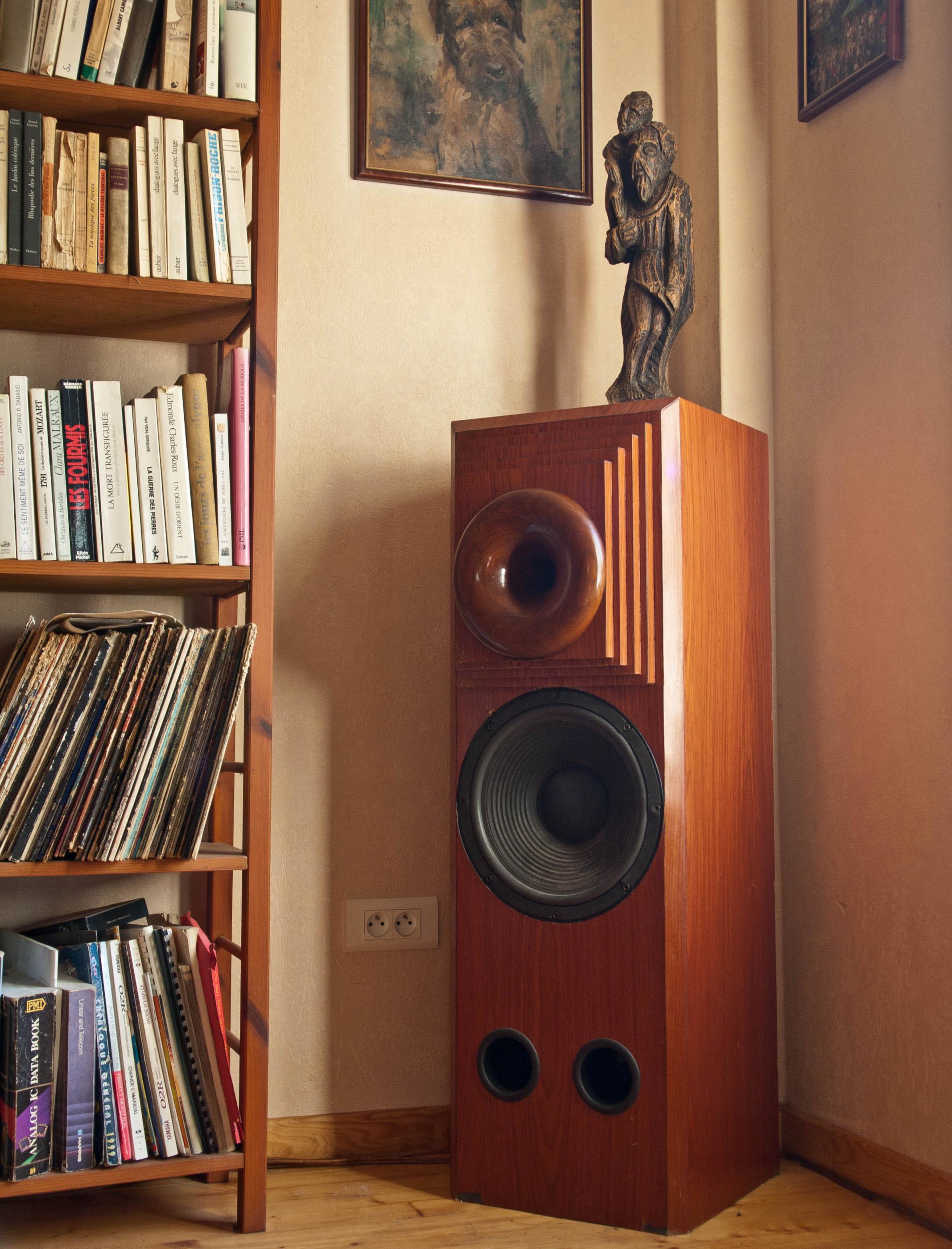

This is an other way to explain what i said, i agree on all. With a detail, acoustic level at xover will not add 6db at high frequencies, but only ~3db.
I insisted several time, here, about the importance for the two speakers of the two ways, at the Xover, to have the same radiating diameter. Reason why i prefer horns.
The try of a more WAF enclosure for Aeria sytems:
MHP (la Maison du Haut-Parleur) : concepteur français de kits d'enceintes pour la HI-FI et le Home Cinéma...
finished in my home that way despite all the expected advantage of smaller diameter bass drivers (Upper cutoff frequency)
