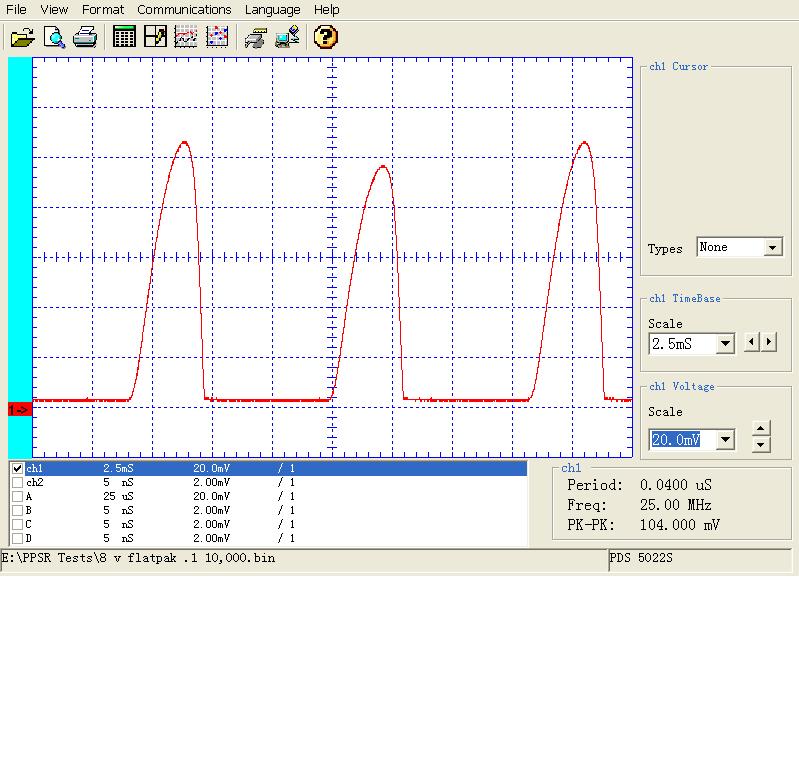

Here is a picture of the current into the half bridge feeding a small power supply. The transformer is rated 16 Volt CT at .8A and the filter is 10,000 uf and .1 uF, the load is 50 ohms. The image is 16 averages.
So what is so interesting?
Unless a transformer has a bifilar-wound secondary to achieve the center tapped operation, the two halves of the winding will have different resistances, if wound one on top of the other for the same number of turns and hence open-circuit voltages. This leads to a lot of fundamental coming through when you draw current.
And what are the other solutions? BTY this is from a Signal dual primary dual secondary flat-pack!

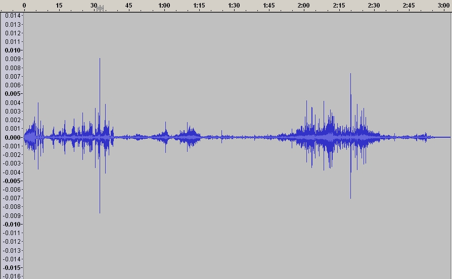

Many talk of the "evilness" of MP3 ... or is it? I took the right channel of that 2L recording of the Britten work, 96kHz, and gave it it the MP3 treatment ... gasp, horror of horrors, it must be totally ruined!! Let's see then: to make it fair I used Lame and forced it to use high quality options, a bit rate of 320kbps. But still, the 52Meg file was clobbered, to output a file just over 7Meg. Heavens, the track must be completely ruined ...!!
Okay, suck the 96k file into Audacity, and the generated MP3, synchronise, invert one and mix, and what does the difference file look like? Like this:

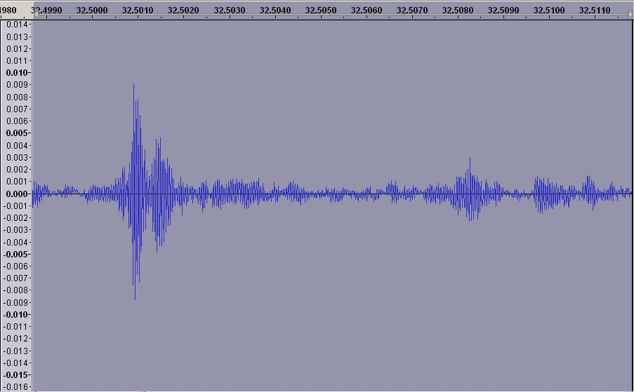

Hmmm, mostly down at least 60dB, not too terrible; but there are a couple of nasty looking spikes, what's in them? Lets zoom in on one:

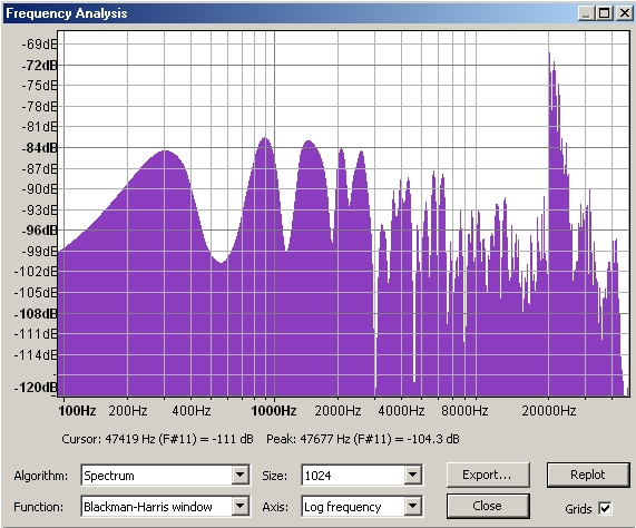

Well, this looks to be pretty high frequency stuff, I don't think it's going to be audible. But let's look at the spectrum of just that zoomed in bit, what does it show?
Oh dear, mostly very high frequency material - you have to wonder how relevant it's going to be ...
So, this dreadful MP3 business didn't do so horribly after all in processing this "audiophile" recording, so why does it sound so terrible, I wonder ...? 😀
