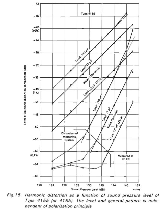

If you want to be helpful, find the equation for distortion from a mike capsule with a varying capacitance under vibration against a fixed load capacitance.
Here are the measurement results from bktr79-4
I think this is what John wants. B&KTR 96-1
Reduction of Non-linear Distortion in Condenser Microphones by Using
Negative Load Capacitance ...................................................................... 19
by Erling Frederiksen
It contains a full mathematical derivation of distortion as related to load capacitance, with verification by mechanical measurements.

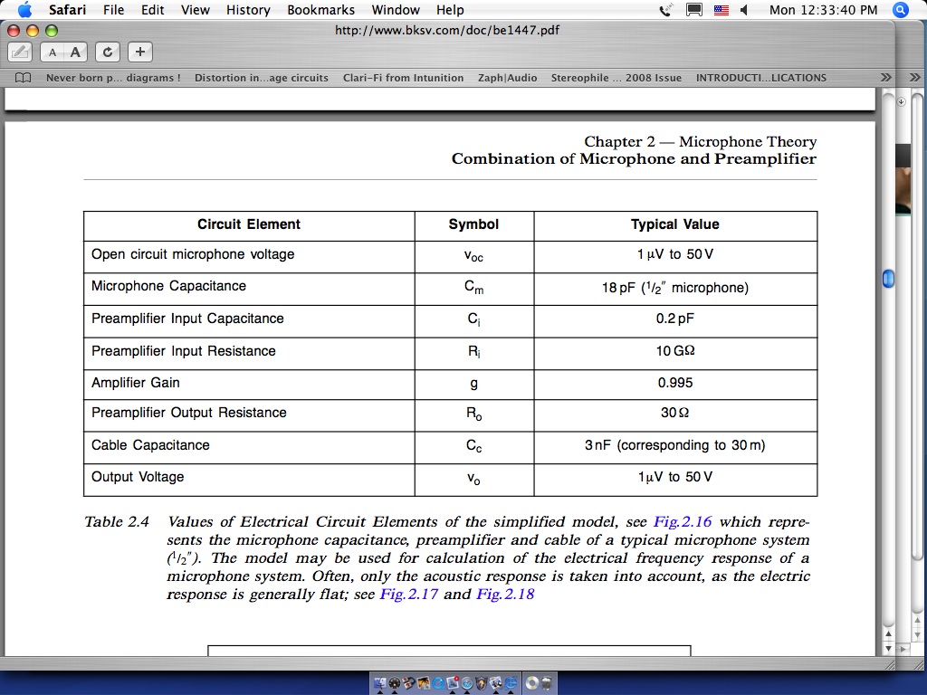

Wavebourn, resistors have capacitance too. Earling Fredrikson told me himself that this was the reason when I visited B&K in 1974.
However, if they were dealing with high parasitic capacitance of resistors, they were right. Were they multilayer?

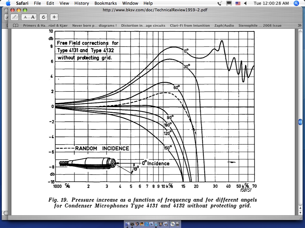

This is what I call a design for a flat random-incidence response. To be used far field. Thx-RNMarshThis goes with previous graph:
JC, are you now claiming that having advised B&K, Ampex and a zillion other incompetent engineers how to do better, ...This goes with previous graph:
... that your Jurassic circuits which far exceed Scott's designs in noise, distortion & sheer musicality ....
... also miraculously compensated for the directivity of a rigid piston at the end of a tube?
I have some small interest in the subject as the Mk4 Soundfield is a better omni than a 1/2" B&K up to 10kHz.
