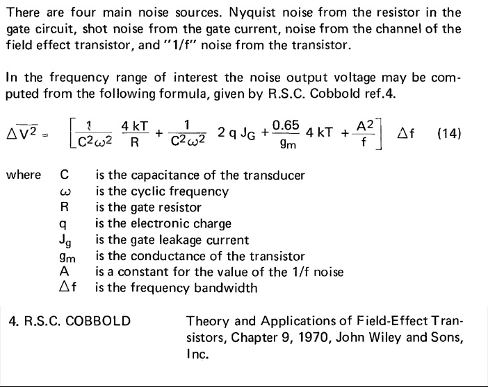

For a charge based transducer at low frequencies the current noise at the input of the pre-amp is what matters. Equivalent current noise of a resistor is sqrt(4KT/R), Nyquist 1928. The noise goes down as the sqrt() of the resistance. Or as B&K quoted in 1972 from Cobbold...

Well everyone, I hope I have given you enough to make my point. However, I am still missing (they are here somewhere) a complete set of noise measurements taken by B&K where they changed the microphone's R's to higher and higher values. It will come around sooner or later. I'll give you a sample, with 100G resistors.
