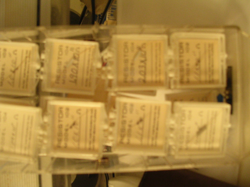

In 1972, I was seeking out 100G resistors. Chickened out using them, settled for 1G and 10G. Still have some.
