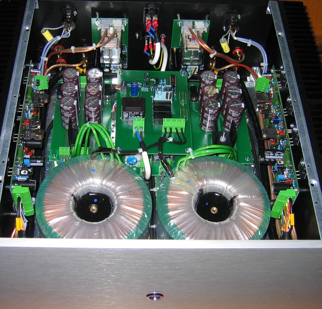

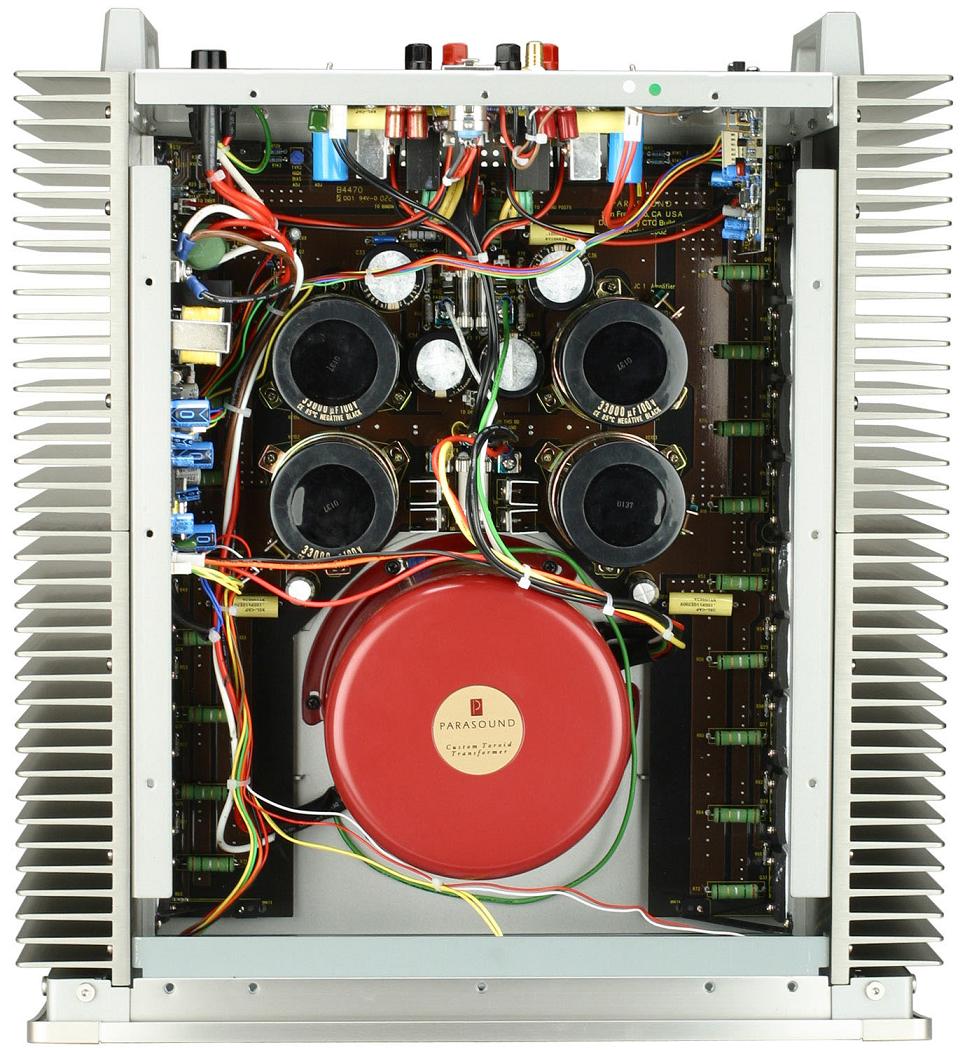

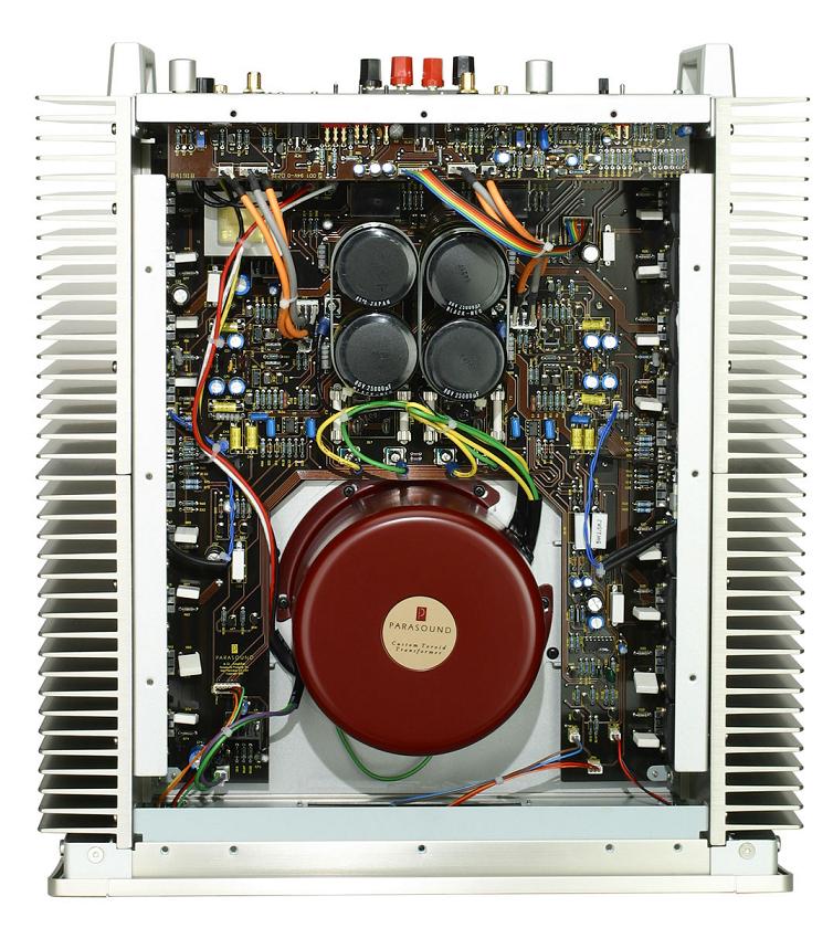

Yesterday I promised more on the designer assigned differences in different power amps depending on price point. Here goes:
Let's watch some pictures, if you do not mind. Hélas, one of them is probably not Parasound 😉
