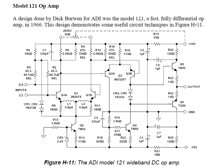

Everyone, I like to attribute where the design comes from, because often people just take, what was initially developed by individuals, most of whom I know, in the past, and they deserve credit for it.
For example, Bob Cordell's design topology is derived essentially from Dick Burwin's work in the 1960's for Analog Devices.
I think that Dick Burwin deserves some credit for his early effort. Just my opinion, perhaps, but then I will take credit for what I have developed on my own, over the decades, because I think that I deserve it. It was new and fresh, when I first tackled the problem. Just because 'everybody' uses it today, doesn't make me forget how difficult it was to convince anyone in the late 1960's to use it, since it seemed so 'over the top' at the time.

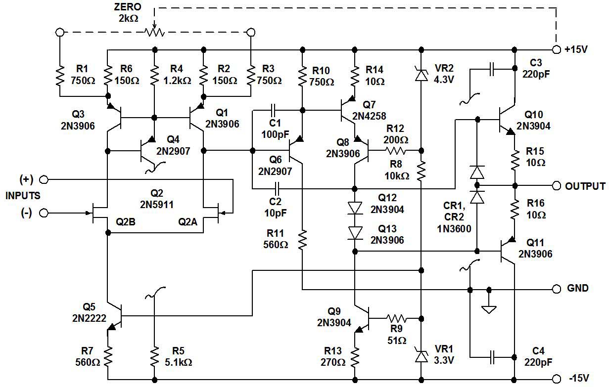

Are you referring to my MOSFET EC amplifier design?
I'm curious, can you share with us the Burwin design or reference you speak of?
As you know, mine is at Cordell Audio: Home Page.
BTW, I assume you are not referring to the MOSFET output stage (they didn't have power MOSFETs back then), or the EC, which was put forth first by Hawksford, to whom I have always given credit for the basic idea.
Thanks,
Bob
Yes, just go to Walt Jung's website, and look at op amp history.

What is wrong with you, must I spoon feed you to find the schematic on Walt's website? Look at it. It is your basic topology, that you, and many others have used over the decades, including Marantz, with the #'s 14 and 15 power amps, where I found this topology first used.

John I don't know what you are refering to. Dick's early stuff was totally ordinary discrete op-amp circuits. Two stage, dominant pole, etc. He used FET inputs, not profound in retrospect considering Philbrick used tubes in 1952.
Please Scott, not you too! Look at his 1966 topology for a hybrid op amp. It is essentially a first diff, second diff, mirror turn-around, and output. 100V/us too! Let's give him a little credit.
If you want to see something closer to what Bob uses, in terms of fets, look at the op amp design of the Levinson JC-2 phono stage. I have jfets on the input and output.
Even closer, the Spectral op amp schematic.

As Scott pointed out, there is nothing particularly new or novel about using a differential pair VAS with a current mirror on the other side. I never said there was. In fact, I never made a claim that my input IPS-VAS was novel. However, I am also unaware of a prior implementation that has all of its features. In particular, show me where Dick Burwen loaded his IPS with a differential current source load with common mode rejection of current.

This one is closer to what I was thinking. So OK Dick deserves some credit for working in the early days. Some of it did not translate to IC's well (like the input L's). This circuit has the basic elements, diff in, current mirror loaded, cascoded darlington VAS, dominant pole compensation. I'm not sure this is Dick's but it's from the same time(?). The part ID's are suspicious so I'm not sure.
