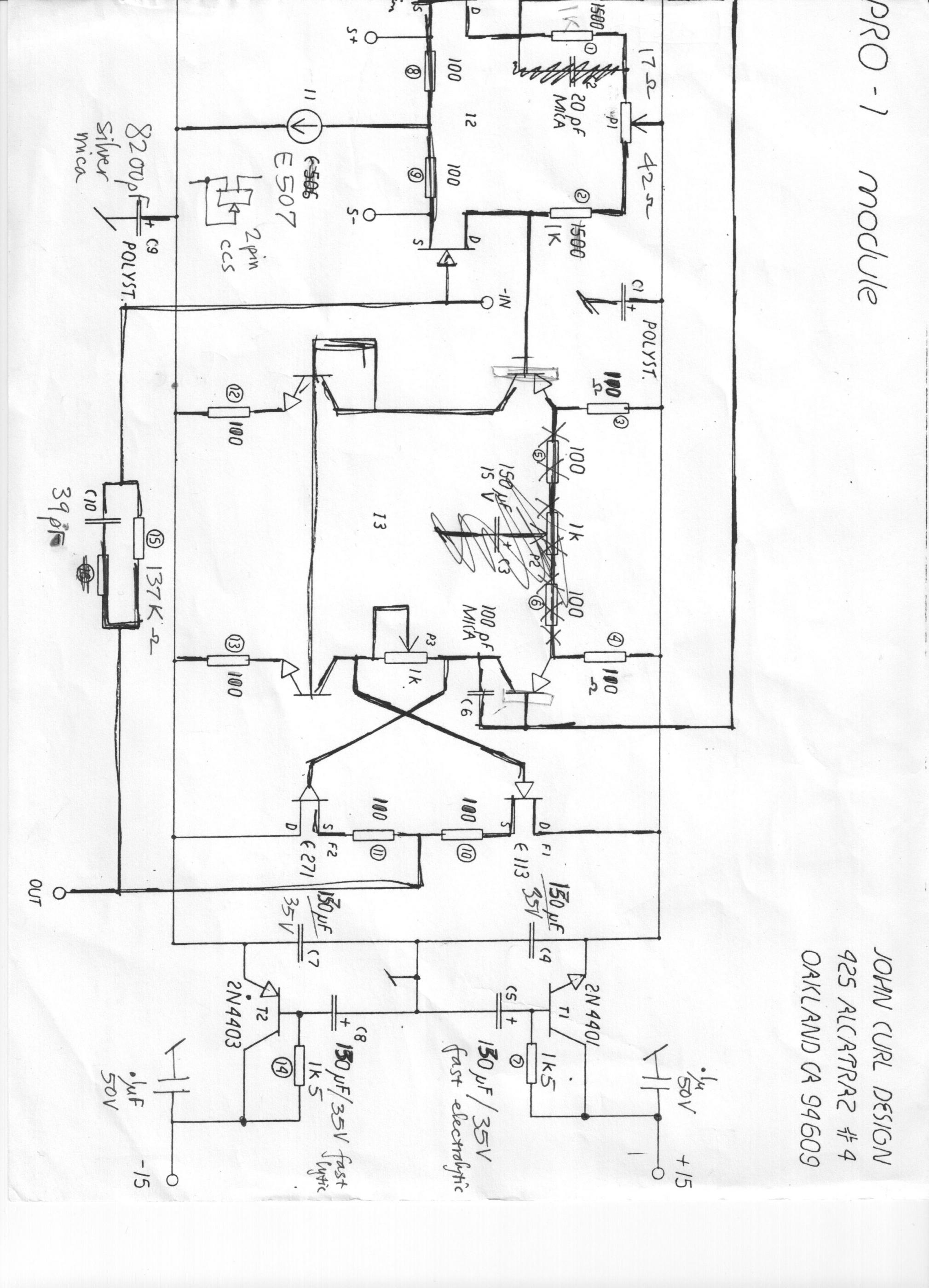

I did once use the Hirata box to test one of my 'studio boards', a professional series of discrete op amps that I first designed in 1977. These boards ultimately went into two 8 channel studio consoles, and three 30 ips master tape recorders.
An interesting (for this discussion) 'addition' that I made to the board was an AC BALANCE CONTROL. This adjustment was added to distortion trim each board, to remove any residual 2'nd harmonic distortion remaining after everything else was matched, due to a slight imbalance in the circuit topology, itself. I do not have a clean copy of this circuitry, but I will put up what I have shortly. In any case, ADDING the AC Balance control caused HIRATA DISTORTION. Removing it, eliminated Hirata Distortion from the measurement to below residual. That was the INSIGHT that I learned from the Hirata test.

Here is the Pro circuit board. The AC BALANCE control is what is composed of a 1k pot, and a 150uF Tantalum cap, essentially, and is shown X'ed or crossed out in the center of the schematic. This is what CAUSED Hirata distortion.
I don't see it unless you created some common mode effect. I have much better luck keeping all trims DC coupled and if necessary include a second trim to bring back DC balance. I have posted several circuits here.
I have also showed how with very slight DC feedback to the null pins you can give your beloved high OLBW amps a DC gain of 120dB and OLBW of 10Hz and they will show no difference in any of these tests.
Scott, I don't know PERSONALLY why I got Hirata distortion with adding the AC balance control parts.

Thanks for the input, PMA. Of course, you are correct. That is why the non-linear distortion generation of tantalum caps was originally missed. Virtually all the early audio designs had a SINGLE power supply, which put DC voltage on both the input and output tantalum caps. This is how we designed audio in the '60's.
