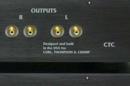

Ikoflexer, we OFFERED to build in a low Z buffer, IF it was requested. This was in our specifications. Every BLOWTORCH was made to custom specifications. You could have: phono, balanced input, different impedance TKD pots, and an OUTPUT BUFFER. These usually cost extra, but they were offered to discerning clients, to meet their specific needs. Balanced output was usually offered without charge, but I have an example here that does not have balanced output, as the client thought it unnecessary at the time.

Anyway, 1k was never a standard. 1k, and sometimes even up to 5k, Zout came from the technical limitations of vintage (tube) preamps and/or its designers. Nowadays, it is really trivial to get a few orders of magnitude lower Zout and that way, orders of magnitude less influence from load pecularities. Tradeoff? What tradeoff?

John, I wasn't criticizing your choices, in fact I find them perfectly sensible. You achieved the results you wanted.
These people are shouting from the hill top that your preamp is obsolete, meaning there are much better choices lately. Hey, the Honda S2000 is an engineering masterpiece, but I'll go out on a Sunday anyday in this obsolete one
[snip]These people are shouting from the hill top that your preamp is obsolete, [snip]
Really? The only thing I noted was a discussion on preamp Zout.
Also, John stated that the reason for the high Zout on the BT was that it was requested by the customer. So, why not give him what he pays for? John is perfectly able to make a Zout as low as he wants, within reason.
But in engineering terms, high Zout is not a good thing because you surrender the performance of your preamp to whatever is hung off of it.

Sorry, but ignoring the problem and leaving it up to the customer to fix it (i.e. find cable xyz) is bad engineering in my book. But I agree, if that is what the customer wants, hey, it's his money.
But anyway, I prefer to stick to engineering. Anything else like you mentioned above comes dangerously close to marketing strategy

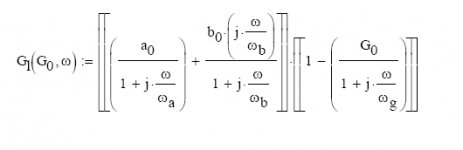

If I may be so bold...
Since this thread is frequented by some of the smartest engineering minds this side of Aldebaran, can I pose an off-topic question (only one John, I promise to leave it at that. Please):
Is there an easy way to determine the zero's in this transfer function:

Is it a quiz or is it something you need?
It’s a Bode equation of a closed loop (with two filters and the open loop) right?

It's something I'm working on atm. It's a loop gain equation.
