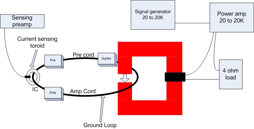

If you notice, my test is just a basic 20 to 20k stimulus of ground current. I had a spare dynaco 400 gathering dust in the basement, so decided to put it to use. I used a 4 ohm series resistor because I didn't like to have a pure inductance loading the amp. That tends to increase output stage dissipation as it goes hard 4 quadrant.
I used an open gap magnet to stimulate the ground loop for several reasons.
1. If I inserted a source into the ground loop, I alter the loop resistance. The purpose of the test is to do it in situ.
2. Using the gapped magnet allows me to just move the flux generator into the loop without disconnecting either PC's or IC's. The alternative, a toroid for example, would work just as well but requires disconnect. There have been anecdotal accounts of insertion contact problems, so I needed to remove that particular confounder.
3. I had one available...😉
I use a current viewing toroid for the same reasons as the loop magnetic drive. A non insertion capability of reading the drive current. Smaller is better of course, as it will slightly change the loop inductance as will the drive magnetics, but hey, something's gotta give.
The reason for the current view is to establish constant drive current. My intent is to establish a test protocol using standards, say 100 milliamps sine 20 to 20k, with a look towards either input referred or output referred coupling..swept.
It would be very good to do this while driving the poweramp hard as well, as there is also coupling between input supply currents from the line, supply dc line coupling to ground, and even mundane things like where the star connection for the input pair is and how it couples.
So watching the output spectra during a sweep no signal, or looking for a specific driven frequency buried within music.
The net end result? Step 1 in eliminating ground loop sensitivities of the equipment.

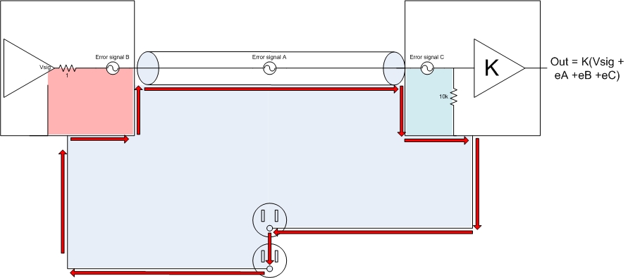

ah, where's my manners...
The pic on the left shows the couplings. Pink is the physical loop in the source component which will generate a voltage as a result of the ground current Blue is the same in the amp. edit(well, the origonal jpegs were pink and blue..) The IC error signal is the voltage generated by the rate of change of flux within the overall loop minus the flux created by the ground current which results.

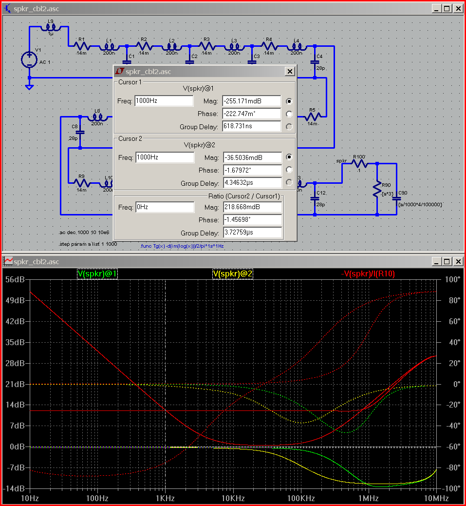

this is intended to address the claim that speaker impedance variation between channels - due to the speakers parameters varying with different operating point could cause "large" us delay "modulation" - due in part to cable Z
used 12' (repeated sections) of Pass 18 awg zip cord model from http://www.passdiy.com/pdf/spkrcabl.pdf
amp modeled with 1 uH isolation L
speaker 4 Ohm nominal @1, step definitions swap in C reactance to give ~ |4 Ohm| 1 kHz Z with ~75 degree phase angle @2
sorry about cursor window over schematic - but you should get the idea - the differential group delay between the loads is ~ 3.7us @1 kHz
to test cable Z role you could parameterize the cable Z - not thinking of that ahead of time - I instead raised the amp, speaker model Z 4x - with the result that the 1 kHz group delay difference dropped to ~900 ns
this basically should give the same result as dropping cable Z 4x with the same amp, speaker models
so it does look like single digit uS delays at audio are possible with zip cord, low Z speaker - and lower cable Z would reduce the effect
need to parameterize the cable - but a quick check shows that for the same L,C but 4 mOhm per section the group delay difference reduced to 1.2us @ 1 kHz so this low at least the effect seems to be dominated by cable series R

If you match cable to load, will the group delay drop to 0? If so, the model doesn't include the physical length. I'm not aware of how to include the actual physical length into the model.
What would be a good range of speaker impedances to verify? Is 1 to 60 reasonable?
