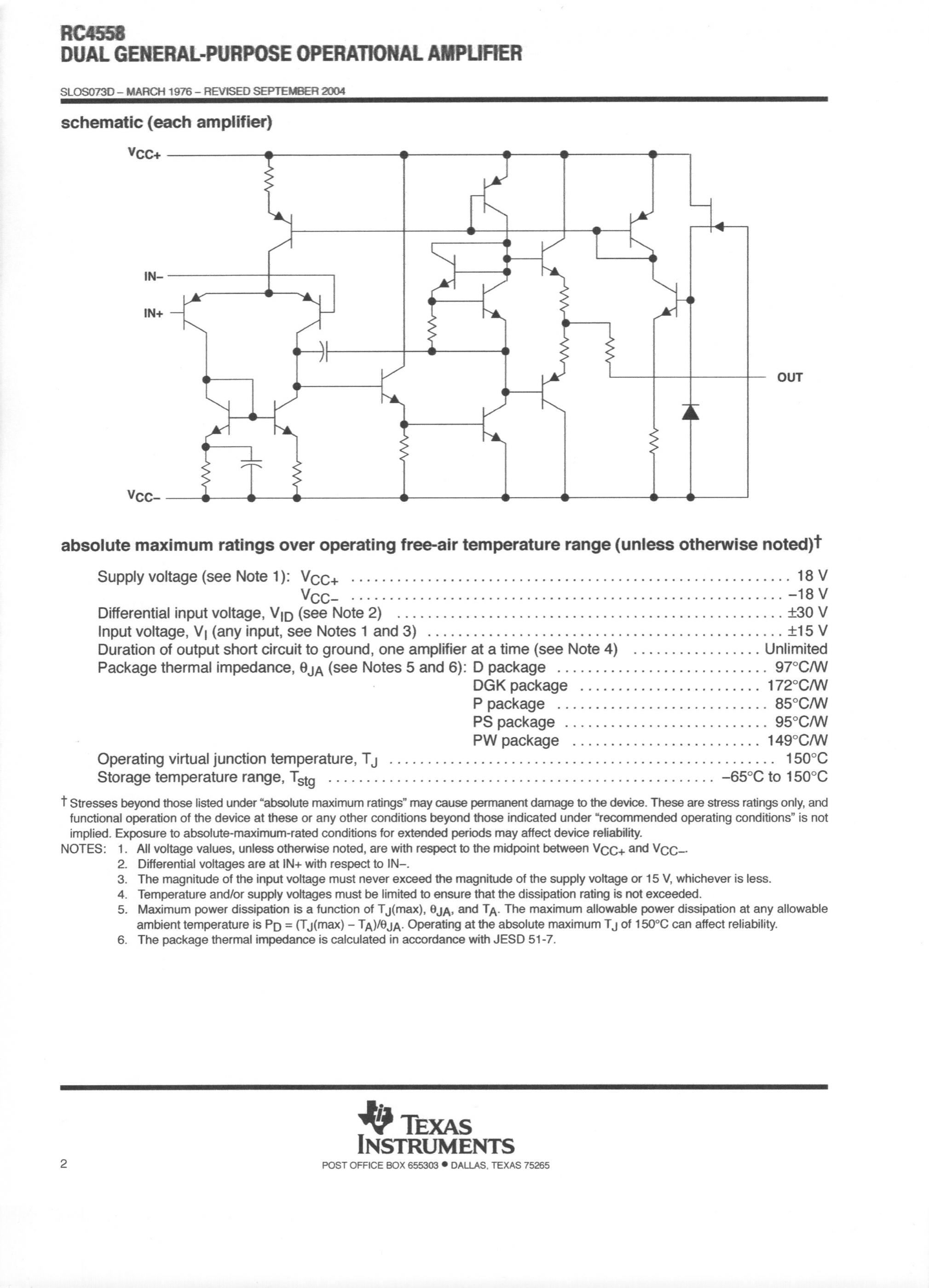

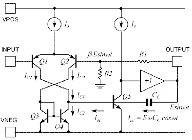

Here's the pic.

4558, well that restrained the discussion, didn't it? Scott, are you not prepared to DEFEND the use of the 4558, even with serious audiophiles? '-)
Unfortunately, even Ron Quan's tests still have a fairly high residual, that keeps us from evaluating the 'better' op amps completely, as their FM distortion (if any) lies below the residual of Ron's test equipment. Don't worry, improvements will be made. Maybe, a BIG company will address the issue and give us serious test equipment to measure this distortion. I sure would hope so.
4558 can't use 'em ;), we don't make them anyway. Ron's tests would probably yield to a digital solution with a high quality A/D and enough raw data.
Now address the point that highly regarded class A amplifiers have lots of PIM well above Ron's noise floor, and then go back and say again his test needs more resolution. This is just making no sense.

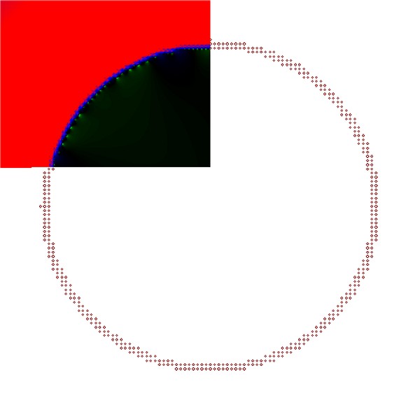

The intent is to eliminate any bouncing of the reference node the amplifier sees. Your technique is certainly viable, but my concern is that safety.
If your amp line-in hot hits chassis, will the path through the pre be sufficient to clear a 20 amp breaker? If not, the possibility of the entire system going hot becomes non-zero.
I note you put the grounding conductor with the IC's, that is very good. If you put the IC's within the grounding conductor, that would be even better. A cylindrical shell of current has no internal magnetic field. (see pic, it is a cross section of the magnetic field of a cylindrical conductor formed by hundreds of individual wires..I limited it to roughly 1/4 of the cylinder due to processor speed, but it shows what happens quiet cleary). If the IC's were routed within a copper pipe or a length of pex with a braid over it connecting the amp and pre, the IC's would have a path which will not see any ground loop magnetic field, there would be little RF intrusion.
The issue would be one of making sure the ground is reliable for life...both equipment's and humans.

Wavebourn, I agree that in mid fi applications, the 4558 is 'adequate' I have been listening through 4558's on an SACD player that I have had for the last 10 years or more. Without DIRECT COMPARISON with better equipment, it is difficult to find any problem. YET, Barrie Gilbert's analysis PREDICTS FM distortion, so we should note it, and perhaps avoid it with our 'best' designs.
John, please see my disclaimer: for higher power gain I would not use them. But for buffers, and stages with gain about 20 dB they are adequate. Of course, I mean biased by 6K8 to the + rail, because as-is they are not acceptable at all for any high end duty.
Can someone explain me this sudden interest in this poor poor 4558, that I would not use more than any TL0.72 for audio or even NE5532 ?
Very high slew rates and current feedback make all the difference between a dump system and an other, fast like light, transparent and light like air, on my point of view.
I'm not sure about 072 but 4558 sounds MUCH better than
LF356 (similar to 072).
