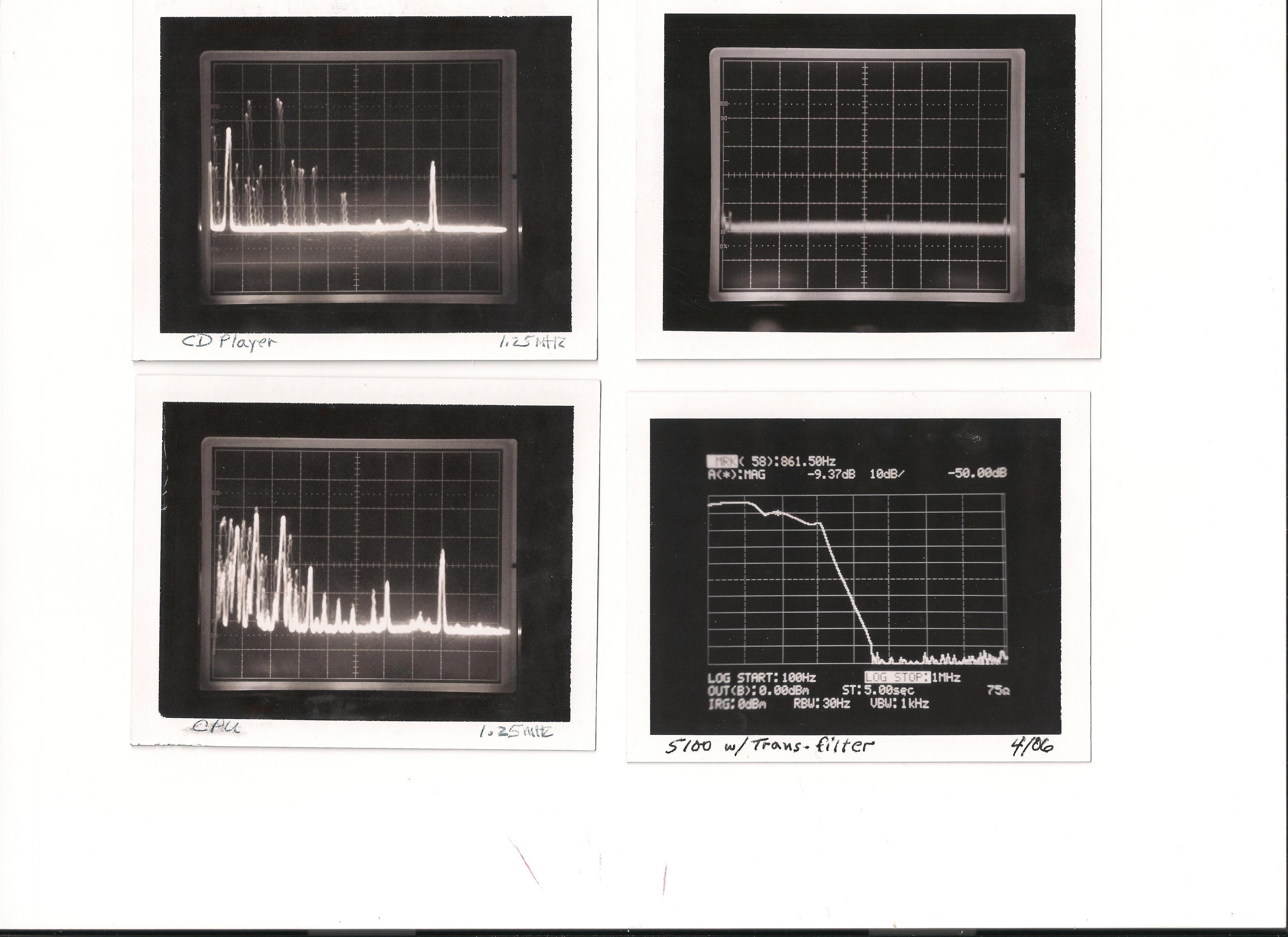

It May be that RFI causes problems that are not seen under single unit testing... but would show up if the whole system was tested (here we go again with marsh and his system testing) --- check this out: See the attachments. Equipment on the ac line produce wide bands of rfi and most power supplies in audio gear are not equiped to keep it from getting into the circuitry. It has been shown that when this happens, significant increases in THD in the amp occures.... Attached are spectrum of 1.25Mhz bandwidth of some equipment (CD player and CPU) that I measured (powered ON) on the ac line. measured with a wideband current pickup probe on the DUT equipment's ac cord. All items on the ac line (TV, lamp dimmers, etc) put a lot of RF on the ac line with thier own signature. I used this type info to create a line of ac power conditioners with outlet to outlet isolation.
This rfi on the ac line may be the real reason why people hear improvements when they use small value caps in shunt on the DC power lines. Or, better, in general with wideband low Z power supplies. A well developed ac line filter with isolated outlets often makes an audible improvment according to listeners. BTW - almost no noise of wide BW and of continuous nature comes in on the ac line. Its coming from within the home, guys. We are our own worst enemy! Thx-RNM
The power line in my apartment is filthy now. It (whatever it is) gets into everything and renders high frequency differential measurements essential below a few tens of millivolts on the line-powered oscilloscope.

That's a very interesting study and I completely sympathize with anyone who suggests that RFI can be injected into the mains power from audio equipment, and be injected into audio equipment from the mains and mess up the sound big time - I think this is why systems at HiFi shows often sound so bad compared with home systems.

Some of the better audio designers keep on top of everything they can. I am not surprised to see that here -- the thread started in--what? 2006? Those two line noise photo's are from my archive and are dated 4/2006! Other data goes back 10+ years before that. What wasn't wideley known and still isnt appreciated is the source of all this line RFI.... it is not from the incoming ac lines and thus you need each noisy product to have a sepeerate filter on its line cord/power input (output). That means Isolation of each noisy product.... which is just about all products. Now that we have everything powered with switching supplies (and on-line wall-wart battery chargers), the RFI from equipment sharing a common line/outlets is worse than ever..... forget about living in an apartment -- the poor audiophile apartment dweller has everyone's RFI producing equipment to contend with. In their case incoming filtering IS a problem as well as isolating their own noise generators. Circuits with widebandwidth are often an outcome of great designs but have a down side, too. Naturally. never a free lunch.
[note the max number and level of unwanted frequencies are generated within the bandwidth of audio circuits. Above those freqs are filtered as required by UL, FCC et al] Thx-RNMarsh
RFI on the AC power lines comes both from outside and inside the house.
