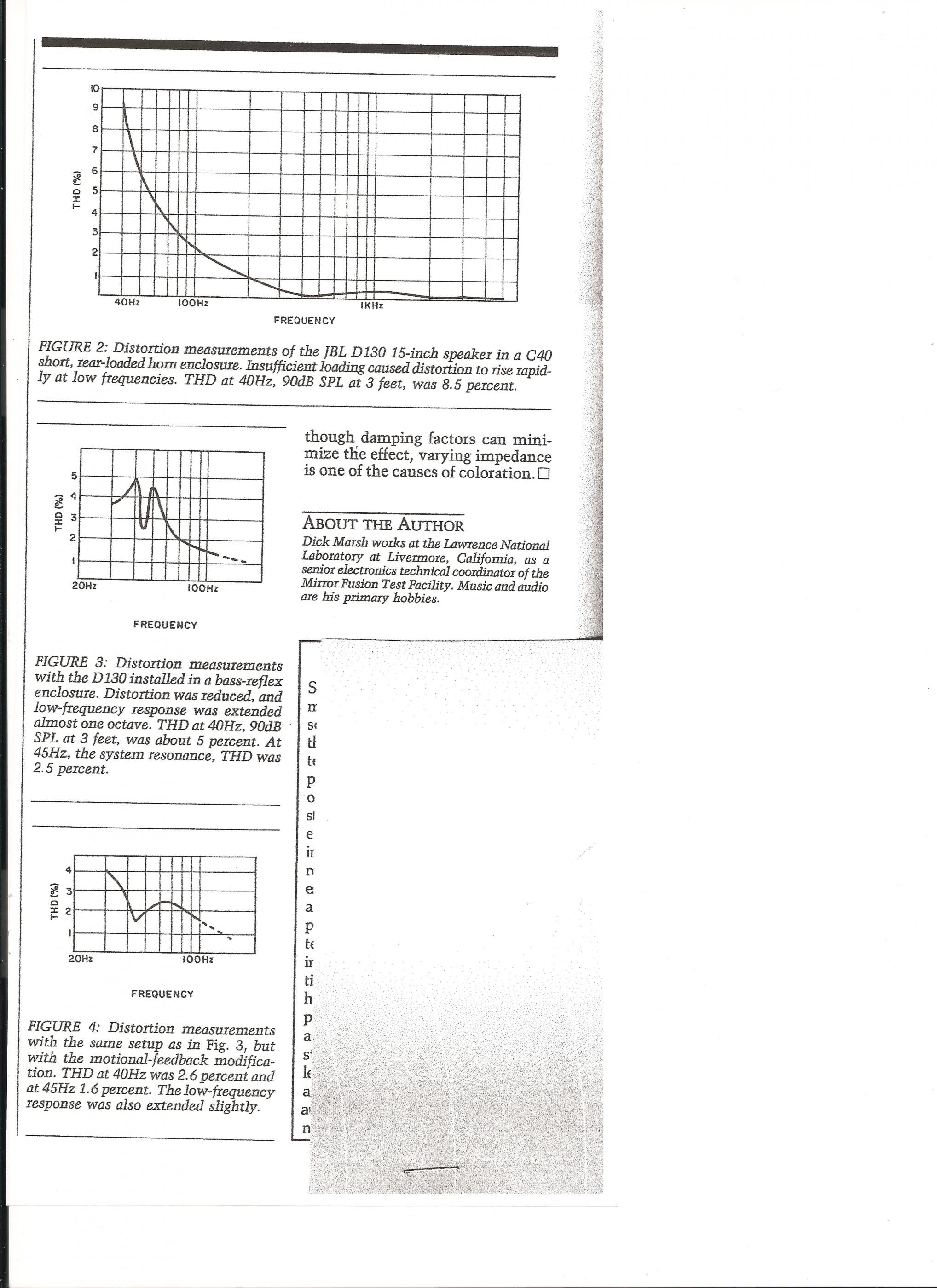

Rs - THD results-
Here's the data on an Rs in the feedback loop --> 1985 -->
first is the raw thd of the driver in a rear loaded horn enclosure (big)-5-6% at 45Hz;
next is the same driver in the same box with the horn cut out and converted to a bass-reflez design 2.5-5%;
The last one is same except with the motional feedback resistor (Rs). 1.6% minimum. Enjoy -- RNMarsh

Thanks for this Mr. Marsh. I can confirm the distortion reduction works for small 8" & 6" speakers too.
A bonus is the speaker will be much less boomy in your reflex example with the feedback.

It is obvious that THD had been reduced by negative output resistance. Draw the graph of THD versus excursion on the same frequency and you will get similar results with horn, port, closed box, closed box driven by an amp with negative resistance.
The initial point was, driver with bigger cone can introduce less distortions on the same low frequencies generating the same SPL. It is also obvious and does not require any proof, IMHO. Bigger cone in equal conditions will require less power and less excursion for the same SPL. That means less distortions.
