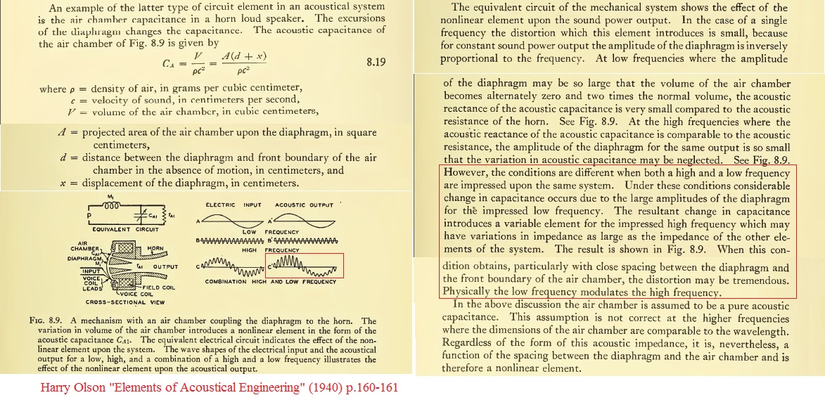

Does JBL have a sellable, working product using these concepts?
I don’t know if fragments of all this have entered the large driver’s manufacturing world.
But I don’t think that JBL is the leader on this promising field (don’t be fooled by the presentation).
I remember a link by Mr. Curl on a current JBL compression driver some days ago. I smiled as I had just read a Bell’s 1928 article http://www.alcatel-lucent.com/bstj/vol07-1928/articles/bstj7-1-140.pdf , as well as Beranek’s remarks over the construction. (see attachment)
