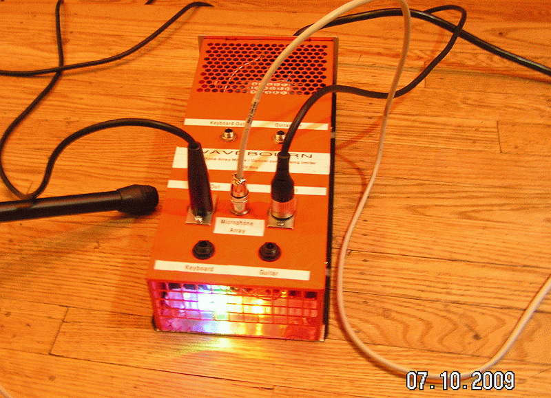

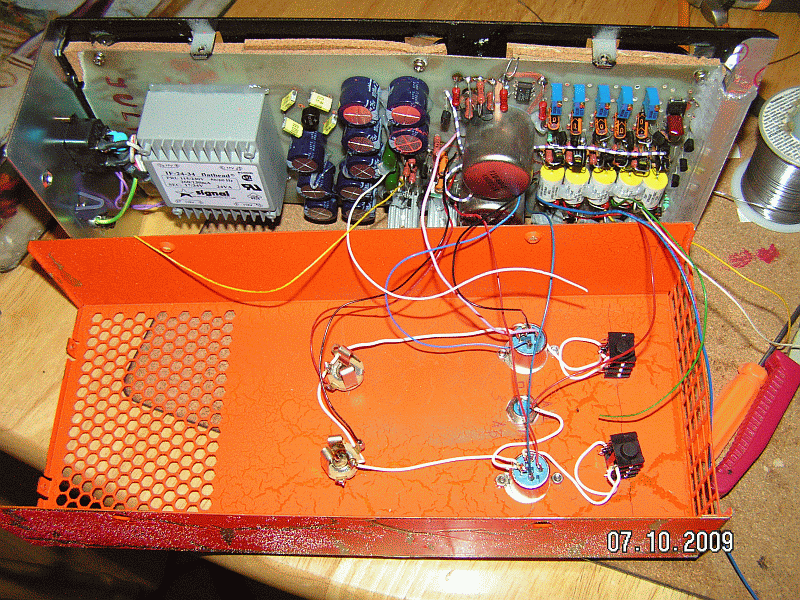

Here is the process of building of a prototype of my microphone matrix. As I said, all capsules were aligned horizontally only. Output was stereo only. Optical compressors - limiters are inside, to disallow clipping due to crest-factor. Bright LEDs on the picture show that compressors had been engaged (I scream to the mic array 😀 )
