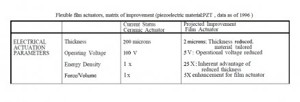

Some principles need materials specs. of a magnitude greater than available so you keep an eye on new materials.
There is a piezo method that requires film with piezo constants at least 10x what is currently available to make it viable as a high quality transducer. In the meantime, they make nice toys.
And extremely efficient actuators (that’s where the money is, where the need is)
Deposition of thin films of multicomponent materials
