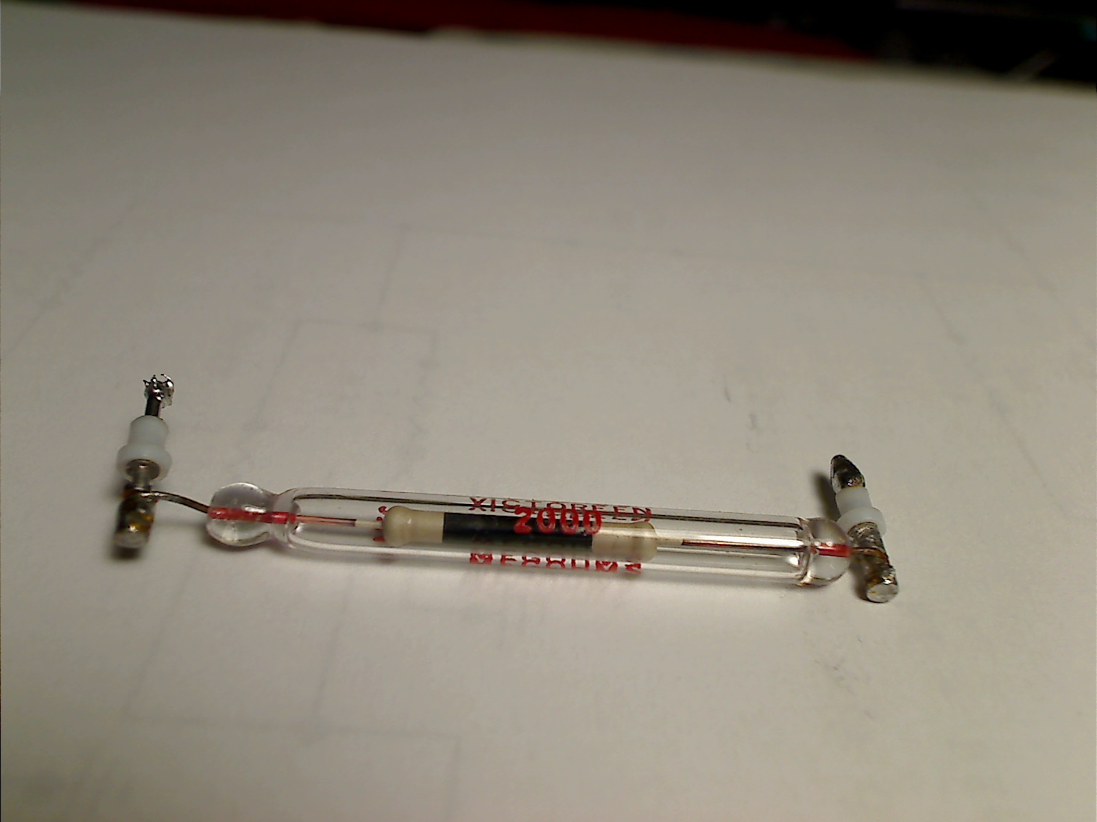

Where did you get these 30-50G resistors? Do they obey Ohm's Law? What's the application?Bingo, I needed those for a circuit with 30-50G feedback resistors, but even so the board needed to be spotless.
I'm interested in these for capacitor mikes.
they were special order from one of the resistor companies, glass encapsulated, silicone coating to make them hydophobic on the outside, the tempco wasnt great. They were used for a flame ionization detector that counts carbon atoms going through a flame.

A Victoreen "HI-MEG" on teflon feedthroughs, 2000 megohms in this case. I actually needed it for a measurement of JFET gate leakage recently.
