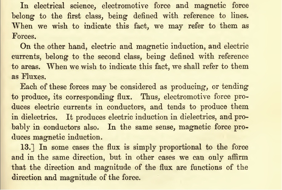

I really hadn’t noticed this part of your post.
I am surprised that I see H and B changing roles.
Maxwell refers to the entities of:
H as the magnetic force of the field and to
B as the density of the lines of force of the field. It names B also as magnetic induction.
Both are vectors.
Vector of H functions over lines. Line integral denotes work.
Vector of B functions over surfaces. Surface integral denotes flux.
He explicitly stated that magnetic force produces magnetic induction. (A Treatise on Electricity and Magnetism Vol I, Preliminary, Forces and Fluxes, page 11, see attachment)
On BH diagrams, H is the abscissa on the horizontal axis.
B the ordinate, is on the vertical.
In modern terms, B is the degree of magnetization a material obtains in response to an applied magnetic field of strength H.
The factor of proportionality μ (B= μH) is not a constant. It is an attribute of the medium through which the lines of magnetic force travel.
Any variation or non linearity of μ distorts B.
George
