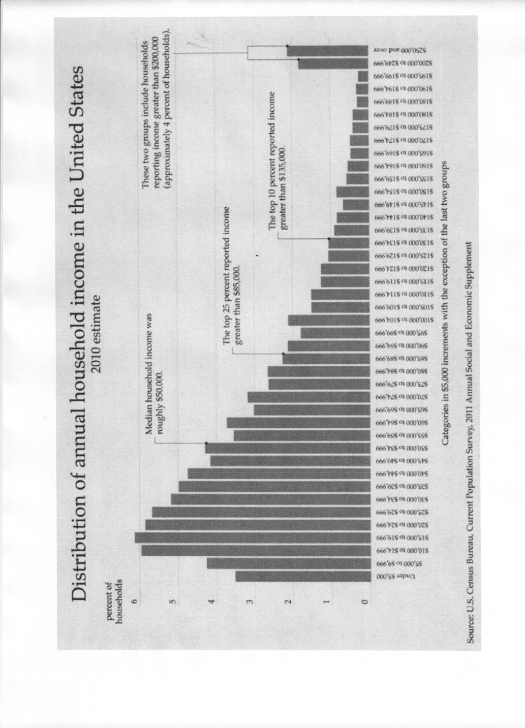

The CTC Blowtorch was really designed for the top 10% of the public, not the top 1%. We did sell a small proportion overseas, but THEY raised the selling price, 5 times, not us.
In the US the 90th percentile is $82,000. I don't know many folks that spend 3 months gross pay on a line stage plus pre-amp.
