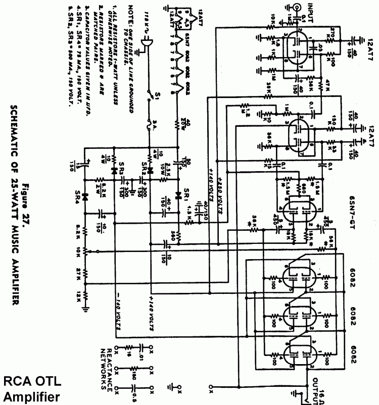

That output stage is a throwback to things like Futterman OTL.

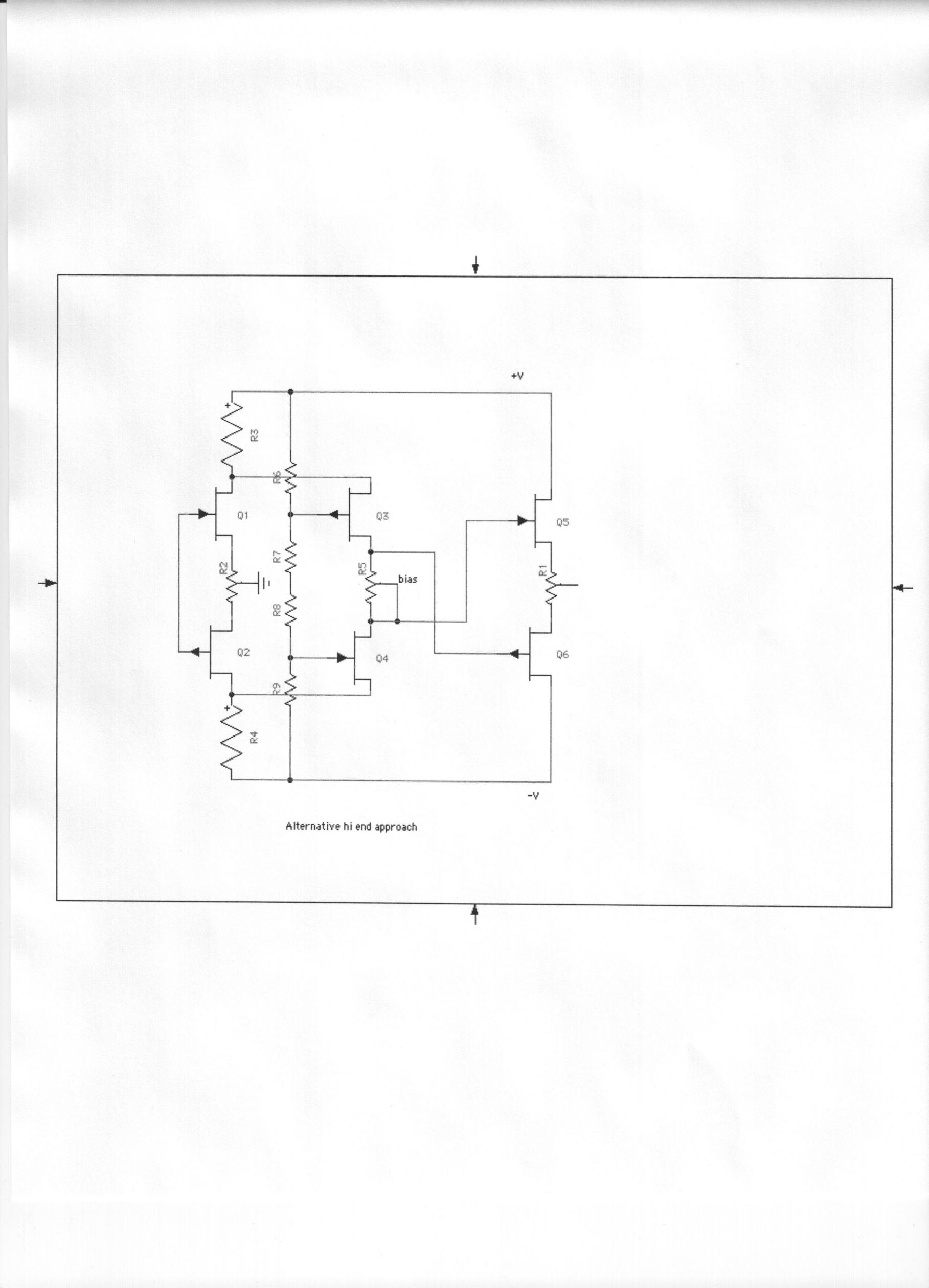

Here's one, the hot chassis is an added feature. Does anyone know if this predates Kaneda?
If you mean that "practical schematic" that John had shown, it is quite different. There 2 currents were applied to resistors between gates and sources of each particular output device. Here triodes loaded on resistors supply voltage signals to grids of common cathode and common anode stages. Gross imbalance. John's version is much better.
When Yamaha brought out the giant-JFET-output model B1 amplifier (below) they had a good white paper about the output stage drive, but I can't find it online. I'll see if I can figure out a way if anybody's interested.
http://my.coolala.net/upload0713/2010/281/1286557087.gif

I don't see the point, these circuits are bandaids when you can make only one good flavor of device. Topologically you can show the same crossover issues with low quiescient bias as if you had a class A/B output and the PSRR is do-do.
Sure nuf. Just another Futterman variant. All Julius' children are playin' his licks.
