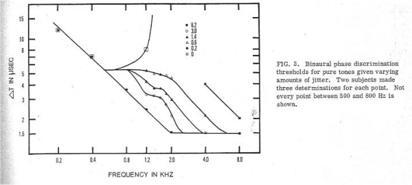

He also filled me in a bit about the 10usec arrival discrimination bit and how it is used at low frequencies and stops working around 1,000 hz.
Stops working around 1k??
I guess you could make the assumptions that everything above 1k is not jittered by cone movement due to lf content, and I guess one could also assume that there are no other pressure wavefronts below 1k to modulate zero crossings the cilia respond to..
jn
jn
That's one method of localization, then others come into play. The interesting issues was when HF is modulated by LF.
His suggestion was to play tones into a pair of headphones and use a phase adjustment on one ear. Above 1K the shifting goes away. I haven't tried it but if you get a different result I certainly will. That would make for another interesting lunch.

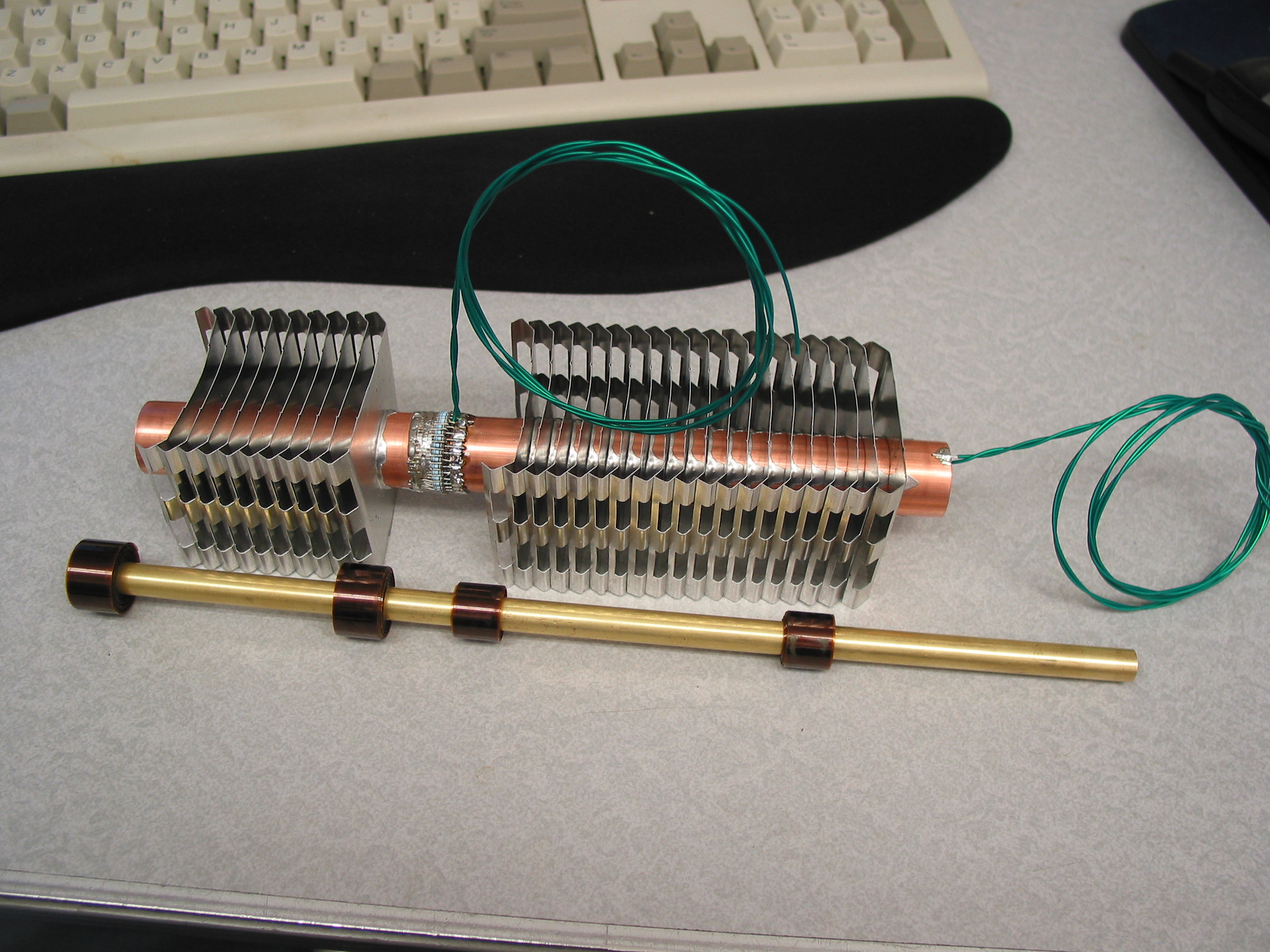

The newton4 method is what I designed back in '81 for my TRR rig. I splayed 10 Be0 10 ohm resistors in a radial pattern on the 1/4 thick copper plate.
The second is a design from NIST, they sold rights. The interesting thing was, they made a large array of resistors just like I did, but they did NOT fold the current back through the array for total cancellation. As a result, they absolutely must keep symmetry in their voltage pickup. Too close to the current leads and there is a leading edge overshoot, too far and the risetime is too slow.
The third, fluke, is like the resistor I made back a ways, it was coaxial by design...pic attached. If you look carefully, it was a b##ch to build. I abandoned it because the coaxial tube structure still had inherent inductance, it's just that the field was confined to the space between tubes. And yah, it's slant fin.. The tube with the four kapton tape rollups is the building/centering fixture. It kept the two tubes axially correct during soldering.
The second and third designs will moniter current very well, but they still will have insertion inductance, it's the B dot component of the measurement leads that they zero'd.
ps..I have that nist paper somewhere in my office, buried..sigh
jn
