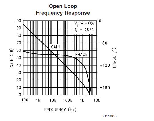

Can you just post a phase gain plot and end all this nonsense?
(not able to myself at the moment)

Ed will this do? I doubt it, but here goes anyway. A typical dominant pole compensated amplifier (90 deg. phase in the ideal case) this one does not accumulate 144 degrees till over 2MHz. A true delay of 20us would be a straight line (on a linear frequency scale) going through 144 deg. at 20k. My experience in this thread is that those weded to these or other mis-conceptions for years will never let go of them.
BTW - LM3875 just to keep the audio theme.
