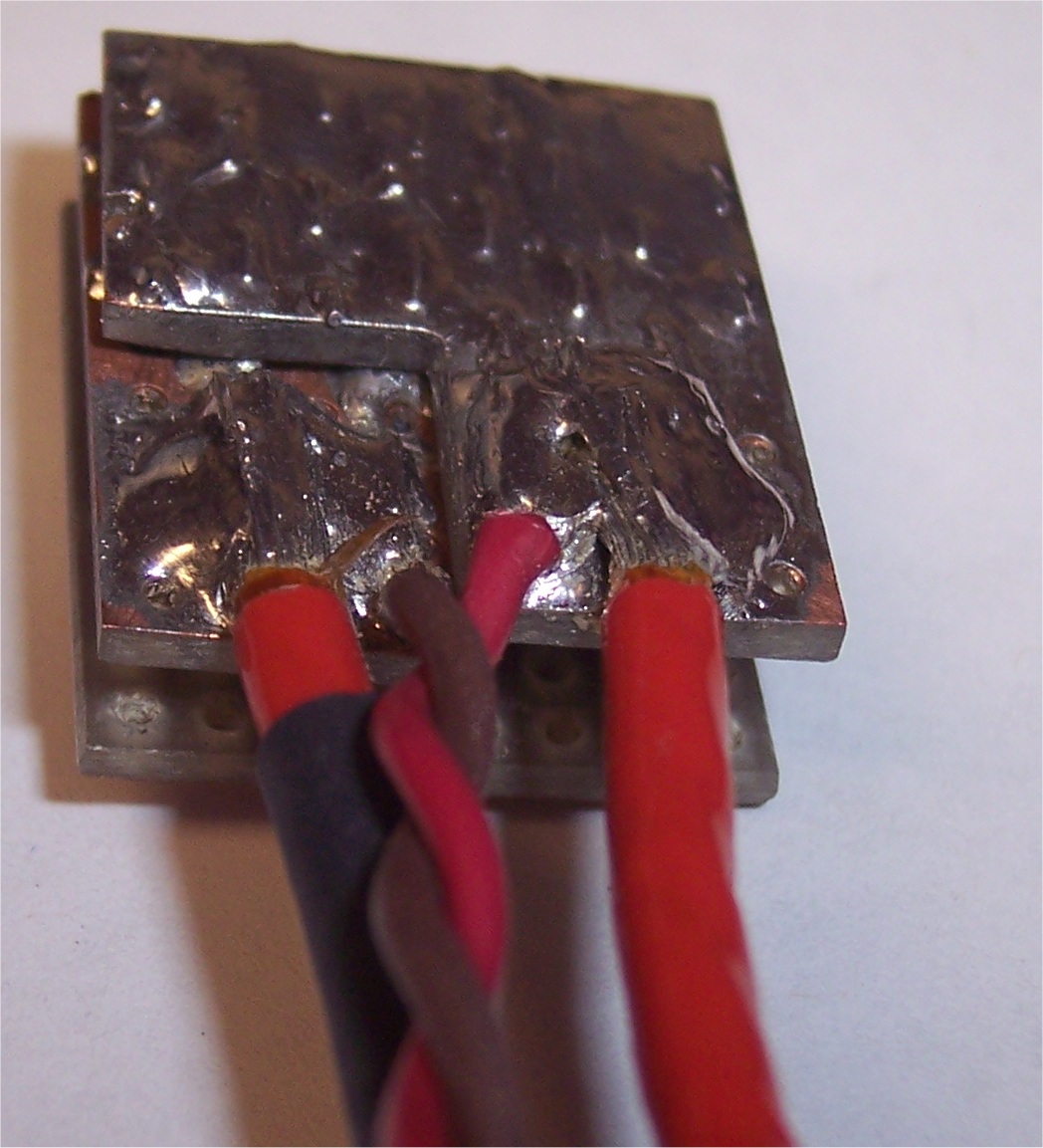

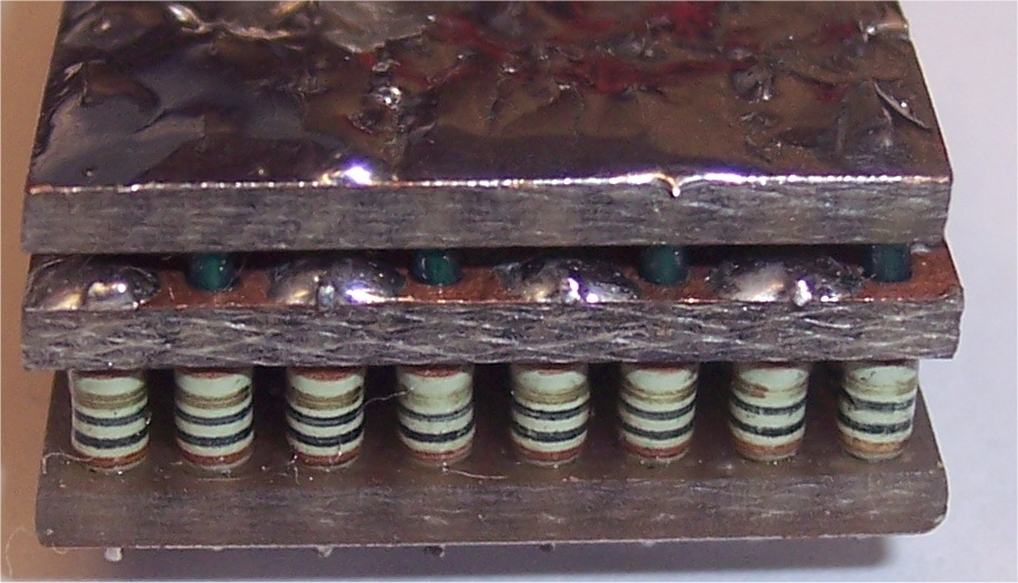

I am not inclined to believe it is a result of the materials used. I would be more inclined to think it is inductance. Not absolute value of inductance mind you, but how the field spreads out. When I need a low value power resistor in the 1 milliohm to 1 ohm range, I just make it such that there is no external magnetic field to speak of. My resistors run in the 50 to 100 picohenry range, but I cannot get reliable measurements below 250 pico, nature of the beast..

I've used both styles in circuits with sub nano response times. As well as BeO thin film cylindrical microwave resistors. None were low inductive (well, for what I needed), and that was because of the current centroid path.
I did find one source of a nice resistor via NIST, but even that is not good enough.
Now I just make em to suit.
jn
ps..pics attached. the first shows the array where all the resistors connect to the bottom plate, half to the top, half to the intermediate. Current goes in the top plate through half the resistors to the bottom, where it then goes back through the other half of the resistors. The current centroid for each path is through the other, so there is no net field. This resistor is made of 40 resistors. Big wire is current path external, twisted pair is for seeing the voltage on the resistor. The overall inductance is close to one resistor pair's inductance divided by 20. If you go larger, say 100 or 1000 resistors, the inductance goes down accordingly.
