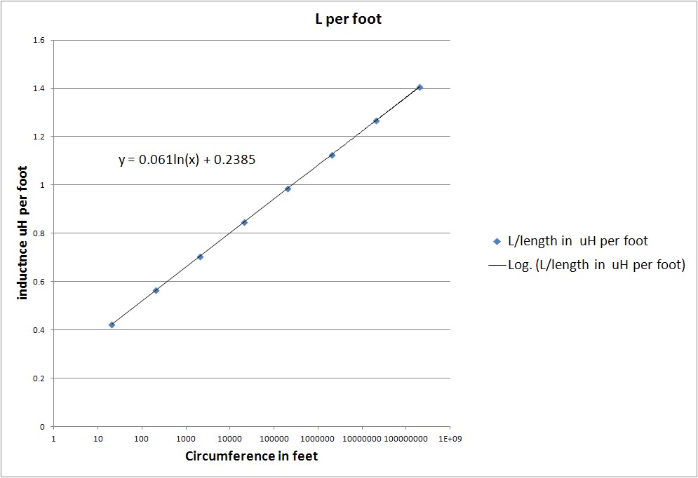

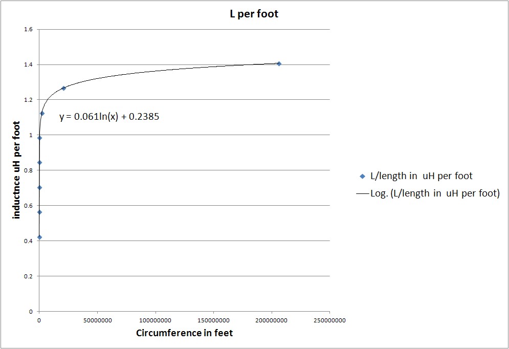

Edit: let me explain.
Start from the closed loop of a wire of the length L. Then increase loops' length twice, getting inductance of it's half in this loop. And so on. The close the diameter of the loop approaches infinity, the close the loop's part in interest approaches the straight line.
I just used an online calculator for the loop...
Inductance of a Wire Loop
Here are two graphs of the exact same data. I ran the radius in meters, and took the inductance calculated, divided it by the length of wire required to form the loop.
I believe our disconnect to be how the data is presented.
You are speaking about the linear graph representation. It appears to asymptotically approach 1.4 plus micro-henries per foot.
By converting to log x axis, a clear picture shows up.
j
I speak of the second graph.
ps. Hadta reupload the graphs, I messed up the graph scaling in x.
Yes. It's how I got 120 micro henries, I made a mistake multiplying by 4 inductance of 2 wires in series, in close proximity, like in case of bifillar winding. However I was wrong, since currents in wires flow in opposite directions.
