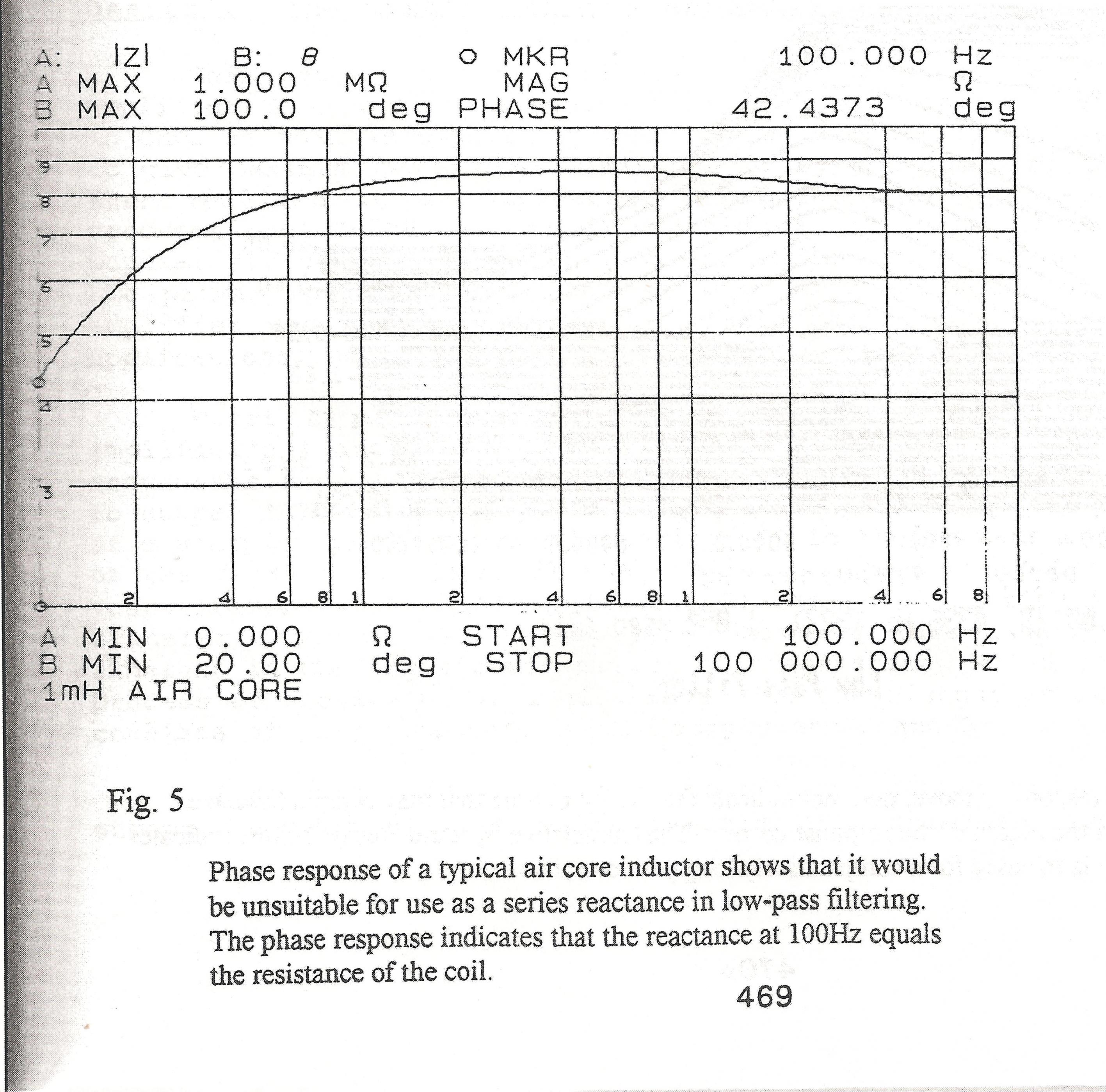

Here is a common assumption that prevents the crossover from being what the sim software says will result. Some assume the phase angle will be 90 degrees but never measure it at the freq to be used. The attachment is of an air core 'perfect' inductor used in speaker crossovers that I measured. Problem is that the phase angle is not constant 90 degrees over freq range and its value can actually only be counted on at 1KHz. You wont get the desired crossover response if the cap is not 90 degrees assumed value..... unless you raise the coils Q at lower freqs by introducing a ferrite core or the like. Its the many little things like this which cause us to fudge/tweak the results to get what we wanted for a result. But, that is never really satisfactory as a better part for the app. --RNM

Who assumes perfect inductors? At the very least you need to add series resistance and stray capacitance, both of which can vary with frequency. A near-perfect inductor is even less likely than a near-perfect capacitor.
??? Really? A lot of people dont measure the phase angle of the actual physical inductor they are using at the freq of use and only assume its value. More series R would make the phase angle or Q less and thus make the problem worse. This is commonly overlooked.
Sooo literal; Examples or proof of concept and the like to get across something --- I am not discussing inductors.... nor caps, really ...follow the thread of thought -- tests that cause issues in listening results are often due to unknowns or assumed things. Like this and that. parts that make up the final product and some known and maybe unknown properties.
yes, a literal L interpretation would be good to put in the speaker forum. But seems to confuse only here.
