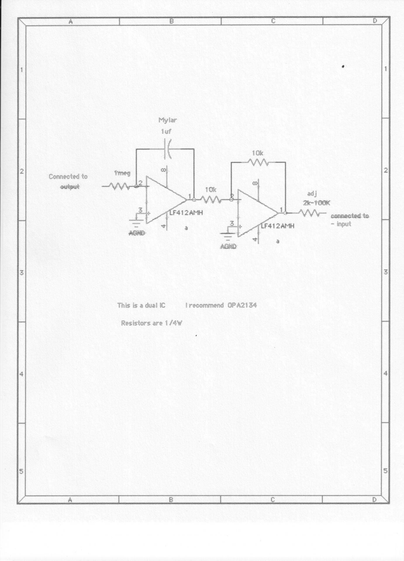

I first started to talk about using coupling caps between stages and in the feedback loop, in order to show an alternative approach by using servos. I have not gotten very far.

As an aside, is there a better name for "servos" ? I always thought this name doesn't describe very well the purpose of the circuit.
I would call them "DC cancellation circuits" or maybe "DC negative feed-back loops" or just "DC loops".

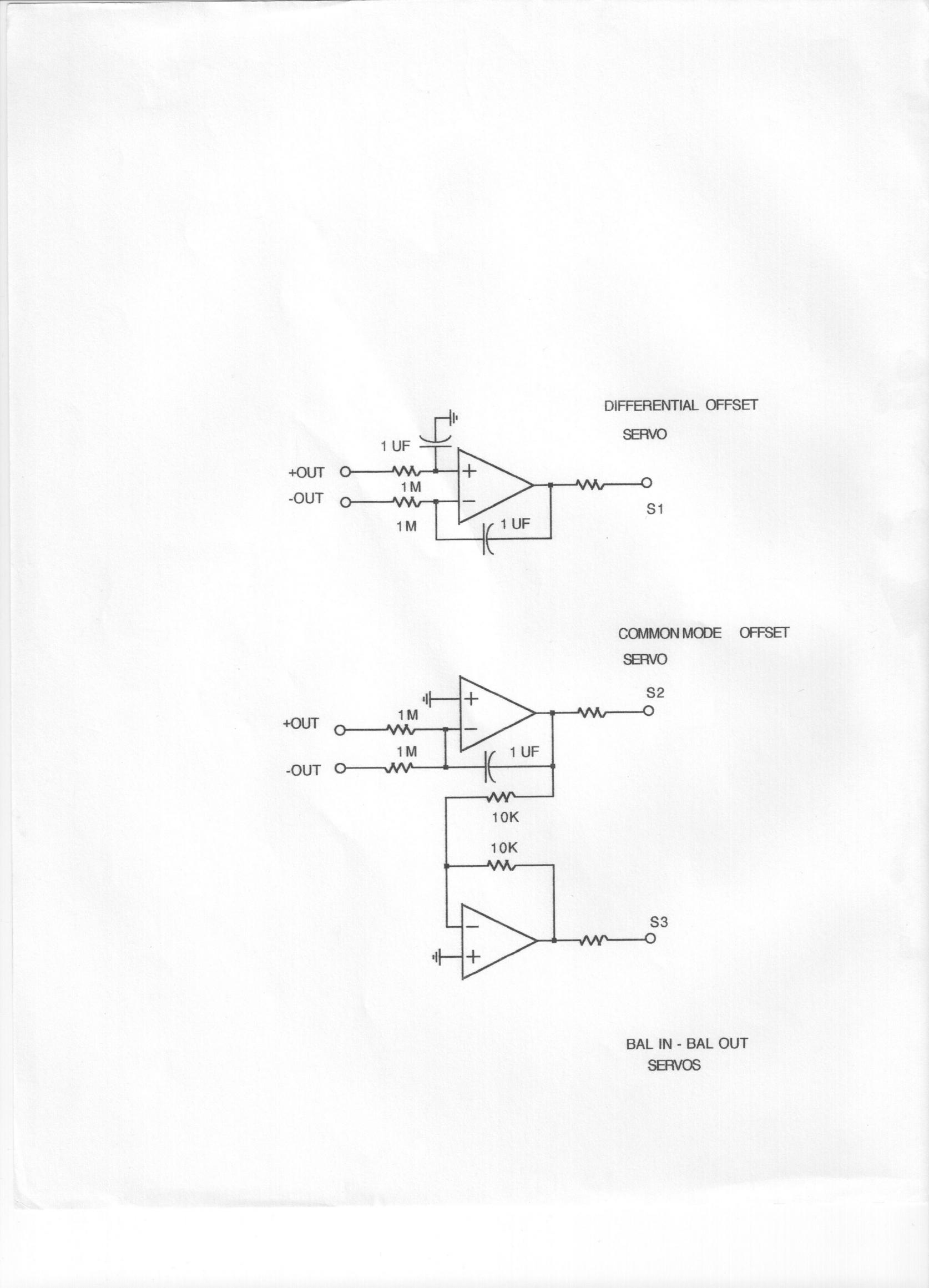

Here is another servo example, one that I prefer, today.
Hi John,
Thanks for the schematics.
Why two IC's when one would do (connected to the (+) input)?
That would require an input coupling cap, which sorta defeats the whole purpose of the servo.
Sy, how can you have a coupling cap in what is a DC amplifier? The first stage of JC's servo is an inverting low pass filter and you can do the same non-inverting, so I guess Joshua is right and save one opamp. But it might be good to maintain the second opamp as a buffer though, because stuff will be coming from the other end (feedback loop).
vac
Thanks.
vac
It's after midnight here and I'm too tired to follow AC vs. DC gain right now. One IC (without a series input cap.) may work and it may not.
