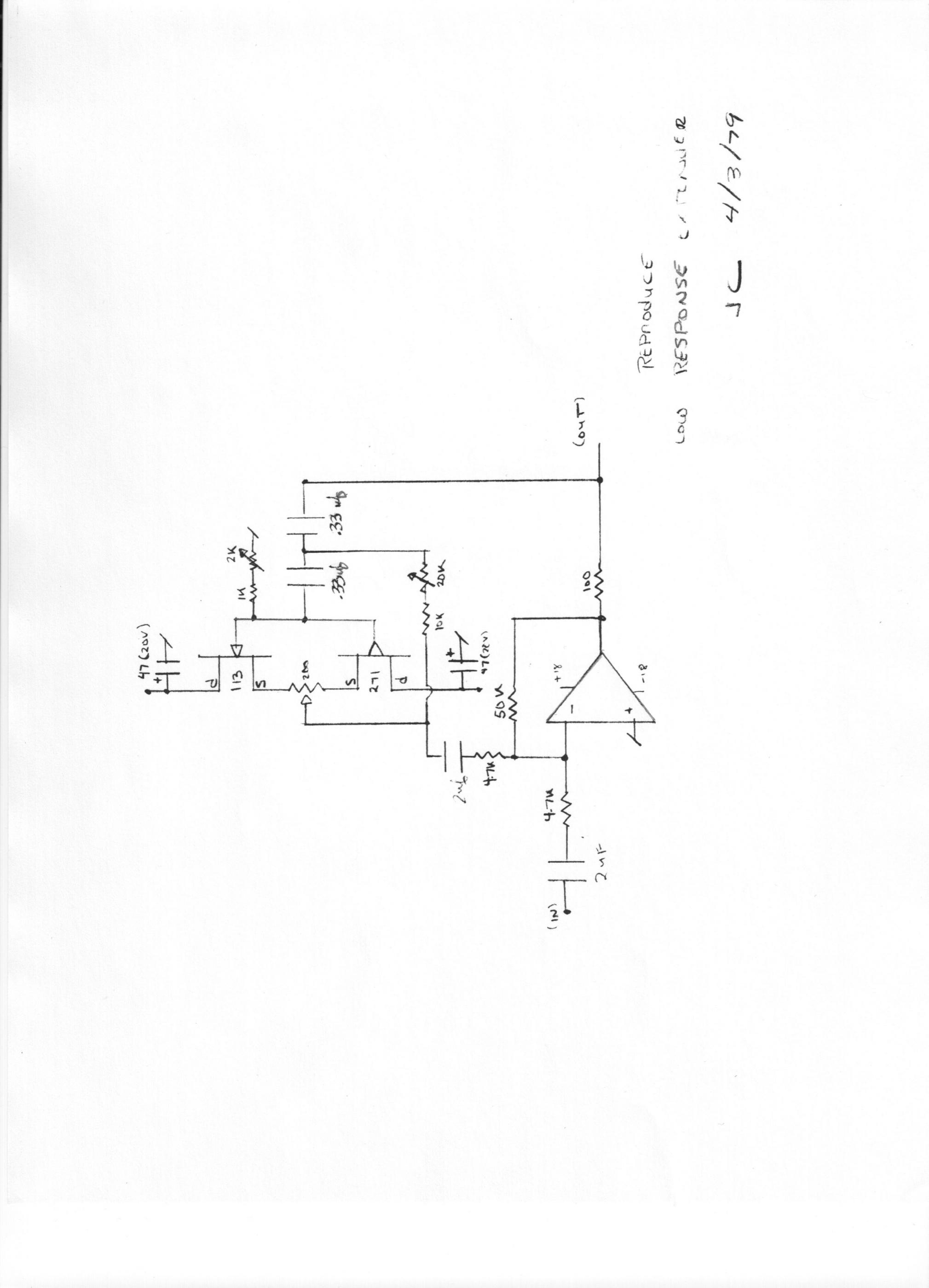

Well, to continue. I found an approach that is somewhat unusual to 'fix' the 30 ips low frequency head bump problem.
But first, I would like to comment a little on where the 'head bumps' come from, AND the added low frequency roll-off below the head bump peak.
The low frequency response limit of a magnetic head is the WIDTH of the reproduce head, itself. Therefore at 30 ips, a VERY WIDE head keeps the low frequency response from following off. The CONTOUR of the head and how it fits the tape passing by it, is what makes the EXTRA ripples in the low frequency response. Many years ago, Bogen (Germany) and others adapted a contour that had a SINGLE bump, and this was easier to make flat.
The Supermaster (1979) used an AMPEX type head, and had a more complicated head bump structure, so it took MORE to equalize it, but the Ultramaster (1983) that Dave Wilson still owns, uses STUDER heads, and they are the 'single bump' contour, so easier to make a very flat frequency response. Of course, below 15 ips, this head bump business, becomes almost unnecessary to worry about. It only becomes important at high speeds.
Now to describe the 'fix':
Looking at the head bump graphically, I noticed that it looked essentially like a 2 dB (or so) peak, 2 pole Chebyshev hi pass filter. I wondered how I could make its 'complement' in a straightforward way. Of course, gross EQ would sort of work, but would that really give the 'transient response' and the 'best fit' for the problem.
I realized that if I could 'emulate' the head bump with a Chebyshev filter, AND put it in the feedback loop, somehow, I could better flatten out the low frequency characteristic.
So, I tried a number of computer solutions, until I got it pretty close.
This was so much better than the Ampex or the Studer solution to the problem, that it was probably patentable at the time, but that was a long time ago.
Next, I will show a partial solution to the problem.

John, that is BRILLIANT !I realized that if I could 'emulate' the head bump with a Chebyshev filter, AND put it in the feedback loop, somehow, I could better flatten out the low frequency characteristic.
I've failed to se a HP filter with Chebyshev characteristic there when I looked at your graphs, I have to admit. Now it's obvious.
