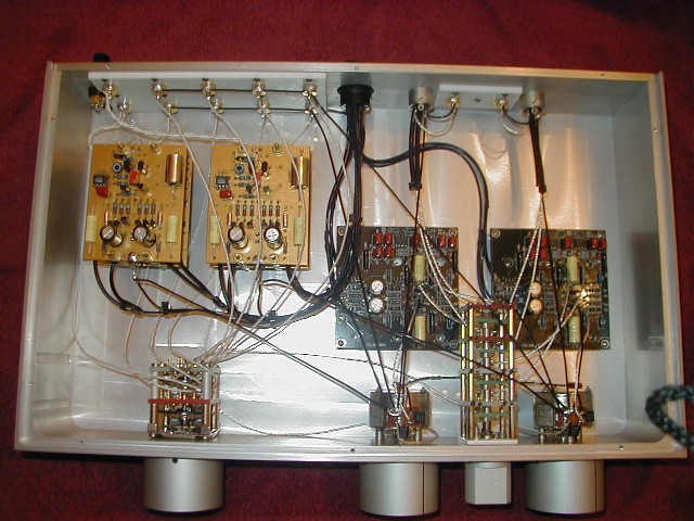

3 mm is approximately 1/20 wavelength of 5.8 GHz. I have chassis made of perforated aluminium, full of such holes. Still, no radio reception. 😀

All this talk of hole size wrt wavelength partly misses the point. We don't have a hole, we have a hole plus wire poking almost through the hole. Inside the cage there will be a rapidly decaying (evanescent?) field from the hole, but it doesn't become zero imediately. Poke a conductor into that space immediately behind the hole and you can sample the EM field just outside the cage. To make a good Faraday cage you need small holes (wrt wavelength) and nothing inside the cage too near a hole. A regular array of holes is called a diffraction grating, so you could get effects which depend on exactly which direction you hold your phone.
A plastic light tube would probably be fine, unless it acted as a dielectric resonator. Isolating the wires would work - chokes or feedthrough capacitors. Making the circuitry itself relatively RFI immune would also help. I think it is unlikely that adding a panel LED to a well-designed circuit will seriously damage the sound. If it does, then the circuit needed better EMC performance anyway so the LED was a useful diagnostic tool.
But he has INSULATED I/O connectors on the rear panel with all those cables going "through the hole" inside the preamp and this is fine??
You guys are exaggerating problems that do not exist and overlooking obvious issues, this is so usual in audio design.
