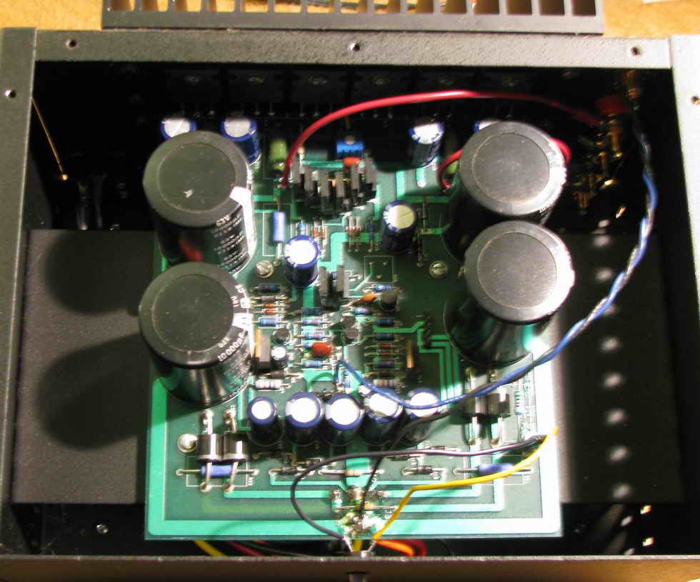

Here is some of my "cheap stuff". 100W mono block 200W at 4 ohm stable at 300W into 2 ohms. The bid to manufacture these at 1000 pieces was under $100 per pair, packed in shipping boxes. They were powder coated. There were no cheap sheet metal screws. I used press in captive nuts and button head Allen screws. Transformers were EI core made in house by the same manufacturer. I don't know what they cost because the bid was for the completed units.
http://www.diyaudio.com/forums/atta...krill-little-amp-might-monoblock-internal.jpg
I built some not so cheap amps also because a customer wanted them. They were 0.195 Al cases with 1" face plate and back panel. Material for the case was just under $250 with an additional $125 each ($500 for 4 cases) for machining. The finished amp weighed 110 lb and didn't look cheep at all.
