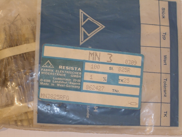

We have also found that the old Resista resistors, especially 1/2W, to be excellent resistors. I used them virtually everywhere in the CTC Blowtorch. The Vendetta being partially Holco (old) and Resista for the rest. This was also a good combination.
Today, I am taking Ed Simon's advice of using Dale (Vishay)resistors that are reasonably low cost and seem to work well. To give you an idea of how well, just look at the May-June issue of TAS on pages 98-100 to find a reviewer's assessment of the electronics made with these resistors. Seems to pass the listening test.
This is what I've been using quietly for the past 20 or so years. Anyone have ever played with these? ;)
Best,

1983 Turned toward Resista parts at surplus, $0.01 each and found that they sounded really good, were available in a number of values, locally.
Started to use them with Vendetta Research.
I have stuck with Resista parts for several decades, including both surplus and new. Unfortunately, Resista is no more, so for major designs, I have relied on Ed Simon's measurements to make a choice. Seems to work.
