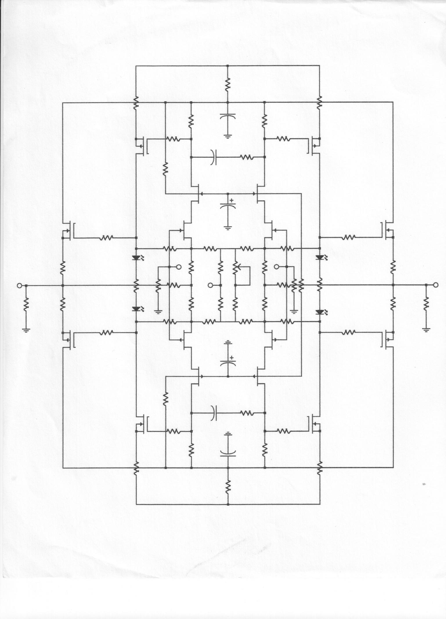

OK, first question, what sets the (approximate) current limit of each jfet on the CORE schematic?
Well, to me the main difference is inclusion of multiple feedback loops in the later design, although it's difficult to analyze it exactly without knowing the ratios of all resistors that are connected to all four Fet sources.

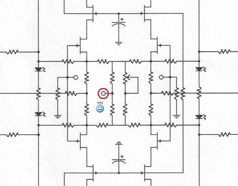

But isn't the ground (0V) in the middle implied ?
But yet if hardwired turns the whole thing class B
the resistor in the middle ?
Yea ....... Center tap it to ground (0V)
If you split the resistor in the middle in halfIt does NOT need a ground reference, except at the inputs.
and put a test probe in the middle .........
What should you see ?
the middle resistor sets the operating current of the four JFETs
one of feedback resistors will reference the JFETs to ground
Distortions of input ignal.
More questions? 😉

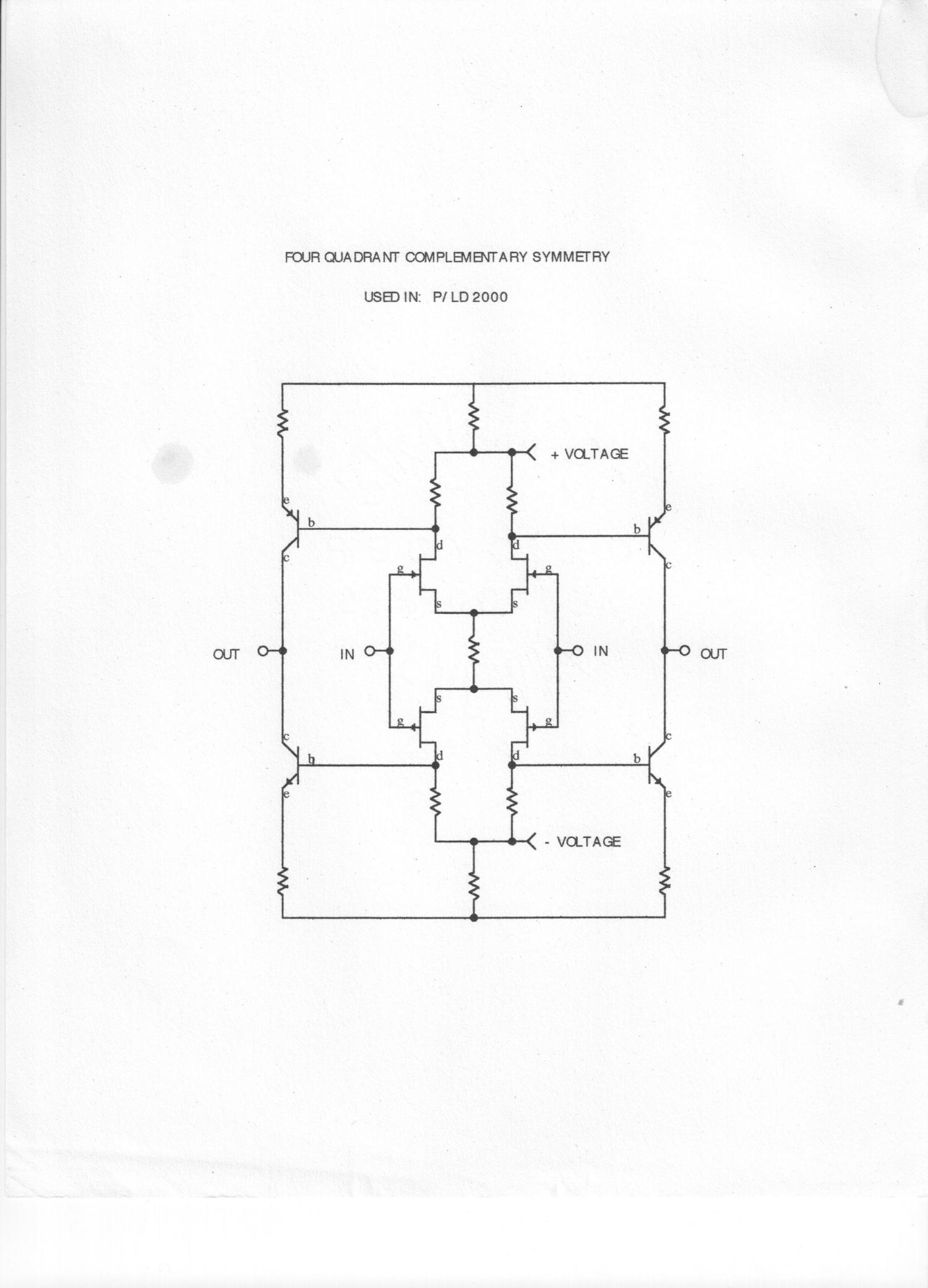

Hi JC,
What is it?
Erno Borbely's articles in Audio Amateur in the 70-ies. Only he managed to do it with all FETs. ;-)
jan
Parasound JC-2 simpified
The link should bring you to post #1515
Add the output buffer's (LED's, resistors (trimpot's) and MOSFET's shown in previous post by John) and feedback resistors.
Two of the components are wrong in the schematic I posted.

Hi Johnless tilted
What's the connection in the center of the diagram for? (aside from "NOT GROUND, DAMMIT!" 😀)
Is it just a test point?
p.s. Looking at it again, it seems that common mode voltage at the input will be transferred to the output, albeit not amplified. Is that not a concern? IIRC, one of Nelson's topologies does the same thing.
