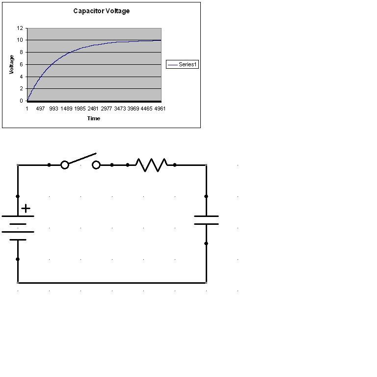

Well let us see if we can find points of agreement and build on that.
There is some source resistance in all real voltage sources.
The voltage across a capacitor governs the charge; V=q/C.
dq/dt = i

You appear to be claiming that the exponential time domain response of a CR circuit somehow creates distortion. Either I have seriously misunderstood you, or you are talking nonsense.
To help with explanation, when we say distortion without adjective, we mean non-linear distortion, i.e. new harmonic components are created. The RC circuit cannot create new harmonic components, it can only introduce linear distortion, i.e. change in time and frequency response (change of amplitude of harmonic components existing in the original signal) without creating new harmonic components.

Ed your reasoning is way off here, a sine wave applied at cuttoff will experience no THD. Without an explicit dielectric problem this is not a source of any distortion not even at your usual levels.
BTW do the force between plates with a nice 0dB line level and you will not see much dC/dt. If you read Samuel Groners stuff there are some fairly mundane caps at <-140-150dB.
.... and it has infinite spectrum, when cut instantly, even at zero crossing.
In majority of cases when people attribute distortions to caps it is really due to non-linearity of input and output resistances of stages they couple.

Capacitors are microphonic, what else is new? The other point escapes me, the log shape of an RC step response has nothing to do with putting a 10Hz sine wave into a 10Hz highpass input. If the capacitor does not have a physical flaw such as non-linear dielectric, etc. there is no distortion.
Yes capacitors are microphonic and even can create noise, that is not new. The issue was that the base level of vibration found most places on this planet with virtually any DC on a capacitor is the primary source of unwanted signal (noise). That is the major dc/dt component.
Walk me through this, there is a voltage source, it behaves as a current to charge and discharge a capacitor. There is voltage across the capacitor. There is a 90 degree phase difference between the voltage and current. So why does the dq/dt not vary?
It's a bit late here in the UK for mental trigonometry, but sin*cos is DC+2nd and sin^2*cos^2 is DC+2nd+4th? Your point is?simon7000 said:So what is the difference between sin (x) * cos (x) and sin(x)**2 * cos(x)**2?
90deg for each Fourier component separately. dQ/dt varies through the full cycle. I'm still not clear which of us is confused. We are talking about an ideal circuit with a voltage source, a resistor and a capacitor?There is a 90 degree phase difference between the voltage and current. So why does the dq/dt not vary?
