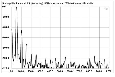

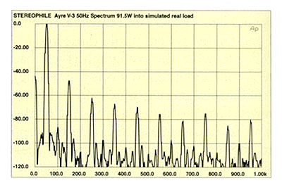

the 7th of several well regarded amplifiers
Nice data. I would not call two of these three amplifiers "Very Low Distortion", though all probably have low enough distortion. Also note that the Ayre MX-R plot is at 1 Watt while the Ayre V3 is at nearly 100 Watt, so at 20dB greater output.
If I compare Tube Amp's we often find less high order stuff, here an example of a "stereotypical" SE Tube Amp at 1 Watt into matched load:
This SE Amp is rated at 18W so the 1W distortion shown here is moderately comparable to to the 17W for a 160W rated Amplifier as shown for the Pass XA-160.
If the power difference is compensated by selecting a suitably higher efficiency speaker (as is a must for SE Amp's) the respective harmonic content would happen at around equal SPL's, if we use an "average" efficiency 87dB/W/m Speaker for the Pass XA-160 it would be at 100dB SPL and if we used a 97dB/W/m speaker for the SE Amp it would be at 97dB SPL.
And here the distortion for a stereotypical Push-Pull Tube Amp:
This is a 100W rated tube amp running at 10W into 8 Ohm, so again, as a percentage of rated power the power level tested is comparable to the Pass Amp.
For a true cabinet of Horrors on distortion (Audax Speaker users PLEASE do not look at this) this little Article has measurements of Speaker Distortion:
As we can see the woofer selected for the project has around 3% H2 at the tested level (not specified but probably at 2.83V input) pretty much across the board and 0.1% H3, at least other independent measurements of similar drivers by the Manufacturer show similar approximate levels.
Ciao T
the 7th of several well regarded amplifiers:
They all look terrible.
Well PMA, it takes a lot of approaches to make an amplifier contest. Please use all the 7th and 9th harmonic that you want. It is just my approach to amplifier design that attempts to reduce 7th harmonic to -110dB or so, if I can.

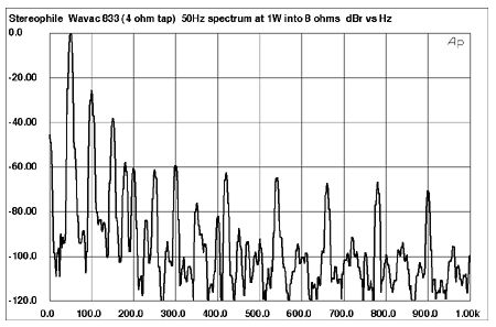

And, of course, an amp that got high praise from John. My goodness, -75dB 7th is OK?
(image from Stereophile, Wavac SH-833 monoblock power amplifier Measurements | Stereophile.com)
When I listened to that amp, it was driving a full range horn, and probably had an output of no more that 100mW at the time, or 94dB or so. Perhaps it would have sounded very bad on a direct radiator speaker, given its distortion performance, but any Class A system has lower distortion by a predictable amount as output level is decreased.
So for $350k, we can keep the 7th down at 100mW. Maybe.

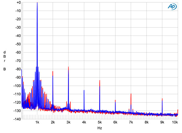

The mains sidebands are worse (possibly) than the Wavac. We talk about power supplies, grounding, etc. a lot, if the effect of these is not taken into account I figure these THD discussions are not very relevant.

When I once heard the Wavac by randomly visiting other listening rooms at CES, I was very impressed by the sound quality of the system. They were using Tannoy Westminster horn loaded speakers (I'm pretty sure), this big tube amp, and playing a record. It was Ella Fitzgerald singing 'September Song' that knocked me out. It was so realistic.
Much later I looked at the 'measurement' of one of the Wavac amps and was very surprised. It looked almost impossible to achieve such a bad measurement at just one watt output. Perhaps it was just a synergistic combination of the horn speaker and the amp that was the key. Since that ONE TIME, years ago, I have never heard the Wavac sound that good, but then they changed speakers, went digital source, etc. at later shows.
The price is 'obscene', but then just wait for the Japanese price of our new Constellation products to appear in stores. We are just as 'obscene' price-wise. Please remember that the Blowtorch cost 5 million yen, in Japan. That's pretty expensive too!
Now that I think about it, it would seem that the Japanese manufacturer, Wavac, probably could NOT lower its price from the Japanese one, even for sale in the USA, in order to protect its Japanese sales outlets.
