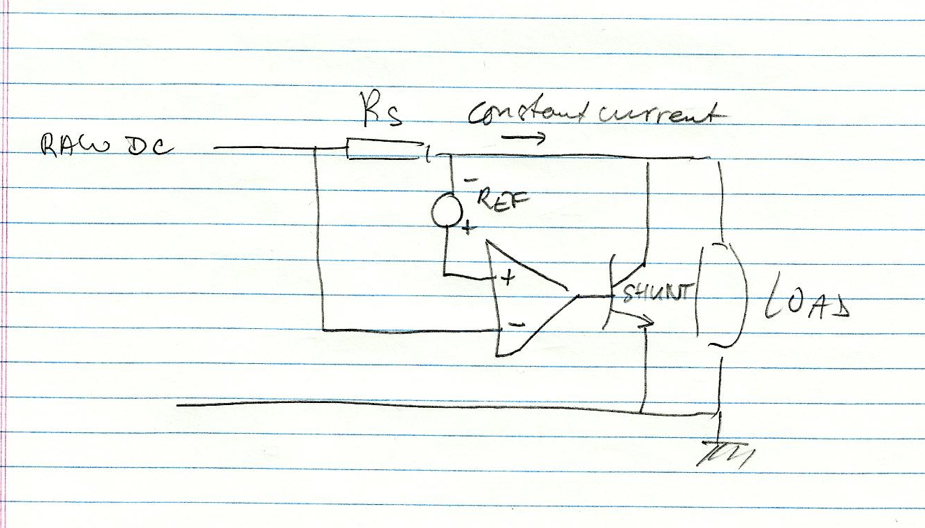

It is obvious, that at least up to 200 kHz, a competently designed CCS will guarantee a constant current flow in the entire loop. The degrading CCS performance higher up can be compensated by an ....
The only varying currents are in the shunt element and in the load itself. It's obvious that those should be close to each other.
I think this is a massive difference to a series regulator supplying a current modulating load, with the modulated current flowing through the whole loop, rectifiers, transformer secondaries and (induced) primaries.
Of course, you could make your active circuit a more constant current like load.....go balanced....and/or folded cascodes.... but that's another (Blowtorch-) story.
Actually, that begs the question: if the purpose of a shunt is to keep the total current constant, why do we design them as a voltage regulator?
If, otoh, we would design them as a current regulator, we would also negate the effects of any wiring between the shunt and the load!
No?
jan

Jan, I think if you are using an active local shunt, you will get better theoretical results if you feed it from a CCS. I think the main benefits in this set up is almost complete removal of AC on the supply line, so no radiation, so no noise coupling etc. For opamp based amplifiers, if you feed them from a CCS, for the local shunt you can use a zener or TL431 with a simple RC filter straight afterwards (to kill the zener or 431 noise at HF) to create a 'zero AC' supply feed. The high supply rejection of the opamp at low frequencies will take care of LF below the cut off frequency of the filter, while above the cut off, the opamp PSSR is aided by the filter. Expect over 110dB from a decent modern opamp at LF. Discrete based designs will usually not be as good as this, so more care with the shunt arrangement is needed.
Sure, you can use all kinds of refinements. I was asking the question if designing a shunt as a current regulator would not give better results than designing it as a voltage reg. For one thing, at the face of it, the current regulating shunt will also 'make invisible' the wiring between shunt and load which a voltage regulating shunt can't.
Maybe should sim both cases with similar parts, to see if there is a difference.
BTW You cannot 'kill' noise or 'take care of LF'. It is always a matter of more or less noise, or more or less LF. For a given set of parts or parts layout, some topologies may be better than others.
jan

The shunt has the job to keep the voltage constant. If it is set as current reg it does not do that.
It is the job of the CCS to keep the current constant.
Incidentally, as no-one wanted bonus credits.
An optimally set up LM317 as series regulator offers around 80dB ripple rejection.
If the 317 is used as CCS and with a TL431 shunt the ripple rejection is around 126dB.
Ciao T

SY, I know that you mean well, but you have not thought enough about the problems that you INTRODUCE when putting a LM317 close to your audio circuits. Look carefully at the Data Sheet on the LM317. Look at the LINE TRANSIENT RESPONSE, LOAD TRANSIENT RESPONSE, OUTPUT Z WITH FREQUENCY, OUTPUT NOISE, and finally the RIPPLE REJECTION WITH FREQUENCY. That is where the problems are. The 317 makes a fair ripple reducer, but it adds noise, transient distortion, and is almost not there above 1MHz, where all the digital action is.
Still it can be useful, IF a discrete series buffer is used, following it, making the LM317 ONLY a pre-regulator.
Shunt regulators are valuable, especially for class B circuitry, where the currents can change significantly. In the Blowtorch, the shunt regulator is only nominal, to create a constant load on the LM317, remove the transients, and any RF that leaks through.
Normal test equipment circuitry usually relies on power supply rejection to keep the problems of the LM317 out of the way, but it is not good enough for hi end audio.
Hmmmm, i'd replace the LM317 CCS with a DN2540 CCS, see Pictures 12A/12B vs. 10A/10B in this article.
Sure, but almost anyone has LM317 in their parts stock, possibly 431's too. Plus the devices are well known.
The DN2540 is neat really a high performance CCS by any standards, a C4S (discrete circuit) can do way better, but that does not change the principles.
Equally, the shunt may be made "better" (lower noise, lower output impedance) than the TL431. But I believe such details are best left up to the individuals.
I was merely trying to illustrate the principle.
Ciao T
