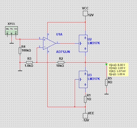

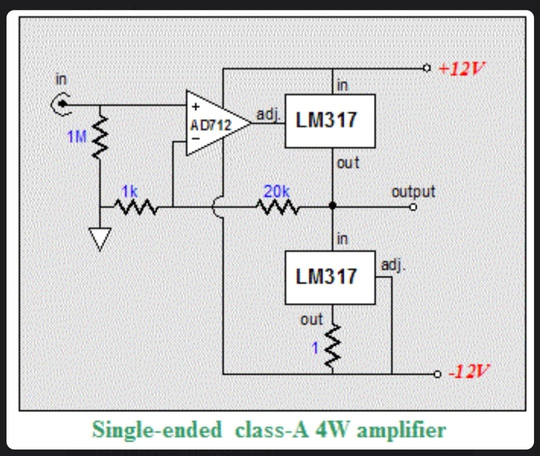

Has anyone here built this very simple, low power single ended class A amplifier based on LM317 and an opamp ?
If so, what THD profile does it have ? H2 predominance or H3 ?
I will try to build it as soon as possible but meanwhile, I wonder if there's anyone happy with this configuration.

It will work even has not very high efficiency.
It is a constant class A supply from the lower LM317.

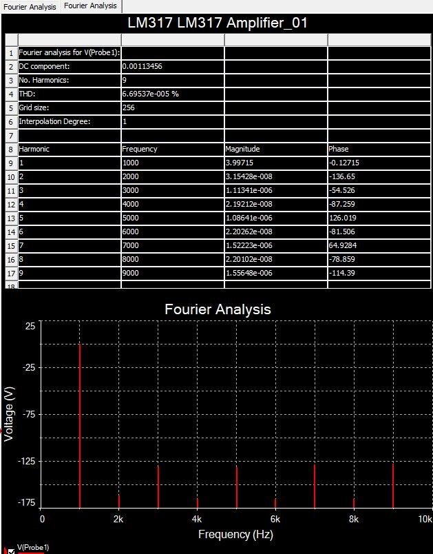

But if you wait I will simulate this circuit. Then I can tell you harmonics.
Edit:
It is more H3 than H2.
The distortion is however very low.
Reactions: radumar1
I started this journey in search of the 'tube amp' sound in amplifiers without using valves. I'm interested in any amp configuration that is able to output moderate but prevalent H2, over odd ones. I had spotted your stereo, three-regulator design which looks very interesting and I would like to build it sometime.
