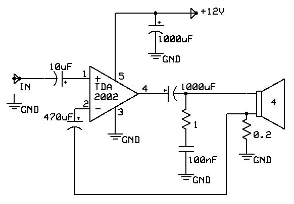

Please, help with this design. The attached image is a modifocation for work in current of the scheme in this page, can be with a TDA2002 or a TDA2003:
Amplificador de audio LA4425, y similitud con TDA2002
Have a old German radio with the two outputs burned, no spares. Mi intention is use two of this low power amps in current for have the sonud of valves.
Also, I have in mind build a small 'boombox' with two low power amps and two cheap fullrange speakers for connect a Sansa Fuze, so I have a 'radio reproductor' with sound of valves, but whitout the inconvenients of the valves. Other people can like made some as this.
Please, is correct, any suggestions?

I can't quite see that working? What is Pin 2? In regular spec schematic it is shown as grounded - is this grounding an internal feedback loop giving 45dB gain as per spec sheet? That gain is set internally.
