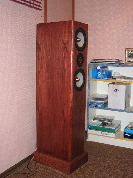

"honking" Thors
I recently built a set of SEAS Thors after reading the review in AudioXpress. The review could not say a bad thing about them. I bought the kit from Solen.ca. Total cost including the supplies to make the cabinets was aproximately $1700 (cdn). For this kind of money I was expecting great results.
Here's what I found:
- great bass extension with good detail (not sure what all the posts about these speakers lacking bass is about)
- good extension with the tweeter, somewhat airy sound
- a little shy in the upper mid-bass region (not the bass section tough)
- midrange is absolutely terrible!!!!
- the upper midrange/lower treble has a real honk or ringing sound to it - very harsh sounding
- because of the midrange resonances, I find this to be a very fatiguing speaker to listen to
I did build this speaker to the exact specifications that are listed in the AudioXpress article. I have since tried different amounts of stuffing as well as a couple of different x-over configurations.
- For those of you finding this speaker to be bass shy, try pulling out some of the stuffing.
- at the advice of Dennis Murphy (of www.murphyblaster.com), I did put a 1ohm resistor between the caps and the inductor on the high pass filter which helped tame the midrange a little (thanks for the advice Dennis).
Overall, I am really disappointed in these speakers especially considering the price. Perhaps I am spoiled. I am comparing these speakers to my 18 year old Infinity speakers which I paid $1500 for at the time. Amazing how well my old Infinity's have stood the test of time.
I'll be very interested to know what experiences other people have had with the SEAS kits (any SEAS kit). Perhaps someone has another suggestion for taming the midrange on these beasts as well.
Cheers.
I think that there is definetly something wrong with the Notch filter ( the RLC which is in parallel with the midbass drivers ). This filter is to vanish the high reasonance the metal cone drivers have at the upper mid region. Either something went wrong during the crossover construction, or they gave you parts with wrong values!!! ( its easy to make a mistake with a inductor for example. Make sure that the resistor of the RLC is very small value, if its a 15 ohm instead of 1 ohm for example , the notch filter will be much less effective!
You should examine the crossover carefully to see if there are wrong solderings anywhere, or wrong signal routes. Check also that the correct parts ( especially the inductors ) are connected correctly. If you dont find anything, you should do a frequency response measurement to see in practice that you have a flat frequency response (which i doubt, something went wrong with the RLC)
A safe way to build the crossover is to do it hardwired with the parts glued on a piece of mdf board. You can check the connections and trace any possible mistakes or bad soldering easy
Dont give up that easy, you ll fix it. And keep us updated, I was thinking of building a set with Excel drivers too..
I agree with you Boom Boom. I built Thors one year ago and that was a big mistake. There is nothing wrong with the notch filter, I have measured the speakers. I also tried 1 ohm resistor but there are still too much energy in the region 3-5kHz. On-axis response looks flat, but the problem lies at off-axis. I think, this can be seen in the AudioXpress article. The midrange could be much more detailed, I dont like it.
