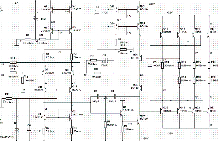

I hope to build the entire circuit within a space of about 1 square inch, p2p. I was going to try with gate resistors no more than 10ohms and see what happens. The emitters of the VAS transistors also need a few ohms. Fortunately, source follower mosfets have appeared to be more stable to me than the common source configuration. I am only using one output pair which greatly reduces the chance of parasitic oscillations between mosfets.:dunno:

I think the Ampzilla circuit is a variation on what Borbely called the "Lender circuit", where the emitter of the VAS is driven by one phase of the diff pair, while the other phase drives the base of the VAS. I can't see where the collector of what looks like an emitter follower is connected.
At any rate, adding an emitter follower to drive the base of the VAS will eliminate the slowdown from the Miller capacitance of the VAS. ....
The 2n5087 collector goes to a fixed reference, and is an emitter follower as you suggest. It's not the Lender VAS.

About current mirror
Hi, Subwo1,
Want to ask about current mirror. There is a guy who said that this kind of current mirror is the "Rolls Royce" of current mirror. Is that ordinary current mirror that you use (and I use) is not good enough, so the sch has to stack 2 of them?
Even one MOSFET can oscillate by itself.
Looking at the Ampzilla 2 schematic, it's not clear to me that the collector is going to a fixed point. It kind of looks like Bongiorno is using the signal on the collector to provide some sort of feedback to the current sources. The decoupling cap is only 0.1 uF, which is effective only above 400 Hz.
At any rate, this doesn't effect the forward signal path to the VAS. I still say that adding an emitter follower buffer on the base of the Lender circuit is just a variation on the Lender circuit. The base and emitter are being driven by opposite phases of the input differential circuit, which is the Lender circuit to me.
I agree that one MOSFET can oscillate by itself. I disagree that paralleling them makes things worse. Just give each device its own gate resistor, placed very close to the output device.
Re: About current mirror
This is a modification of a Wilson current mirror. A Wilson mirror uses feedback to attain higher accuracy of the "mirroring" action.
As with all things in audio, it's best to do some listening tests to decide what to use. Many times a simpler circuit will sound better.
Here is a link to a Japanese site that shows the modified Wilson current mirror. The text is a Babel translation and may not make good sense....
http://babelfish.altavista.com/babe...p/asahi/evo/amp/tech/current_mirror/index.htm
Hi lumanauw,
It much closer to what has been suggested to lower distortion and unload the differential pair. I guess we may actually be seeking speed and simplicity with good but not the best attainable fidelity.
I did some simulation on both stacking current mirrors and also adding emitter follower buffers. I still like the original configuration more because it is more stable. Short signal path inside feedback loops seems to be key. One extra transistor in the signal path can push things over the edge. Integrated circuit op amps may suffer a similar trade-off, more gain stages tend to require that global negative feedback be less near the chip's upper frequency limits ??
I am redoubling efforts toward the goal Kal proposed: simplicity, speed and good sound. I am not sure very low measured distortion is presently the objective.
