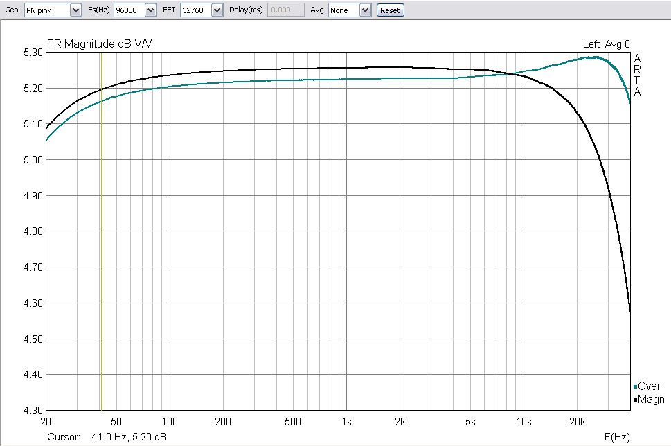

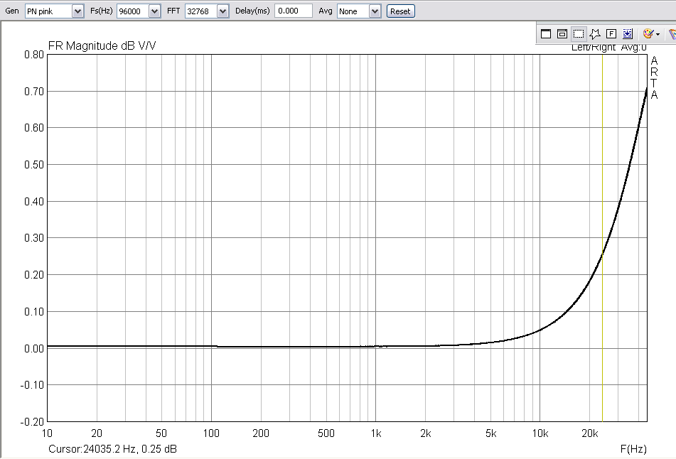

Hi to all member. I hope so to post it to the right place...
I have completed the board some time ago and the last days I have some measurements about this.
At first I am not familiar with this design and my theory electronic background isn't big.
I saw that this filter-buffer raise the upper acoustic frequencies from the 5KHz step by step with the almost 0.25dB at 24KHz and so up over the 50KHz.
Here is an ARTA capture with 96KHz sampling (it is from the headphone output of an EMU-0404 + buffer)
As I know, this filter designed from J.G for the 9022-9023 Sabre dac-chips. If I measured right by ARTA the output of 9023 (after the filter), the following capture demonstrate the comparison between the 9023 direct output via direct output + J.G filter/buffer (the black is from 9023 direct output). The AD captured done by analogue inputs of EMU-0404 (usb).
The upper raise of frequency response is clearly. I don't know if this is a choice by designer or not.

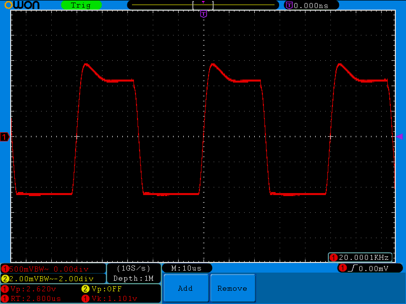

The same seems with the square wave of 20KHz.
Here, the output of Hameg generator was calibrated to 2Vrms (1KHz sinewave) and then a square wave achieved at the same level as before. The signal was driven to buffer input and the output of buffer was driven to oscilloscope for capturing through Pomona 50 Ohm resistor termination.
There is an overshooting, probably normal cause the upper lift of frequencies.
I observed that if the signal was closer to 2.87Vrms (with reference to 1KHz sinewave) the captured square was almost perfect.
Sorry for my english...I would like the opinion of more experienced members with this design.

The filter-buffer was designed for an ESS EUVL DAC.
That DAC already has a passive output filter with a capacitor so the design was done with that cap as part of the filter.
