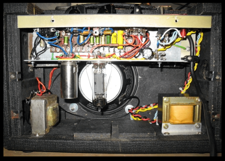

As I indicated above I used the jcm800 front end. I decided on 6ak6 as the output tubes. I followed the advice from Tubelab and put 200v B+ and 10v on the cathode. I do not have a picture of the schematic, it is a pretty straight forward design. The tricky bit comes in the Point to Point layout. Transferring a schematic to the real world is not simple. It took a few redo's and part moves to get it sorted but I got it. I think it is okay for a first attempt at layout. I know I could have made a lace board or a turret board but I was focused on PtoP.
