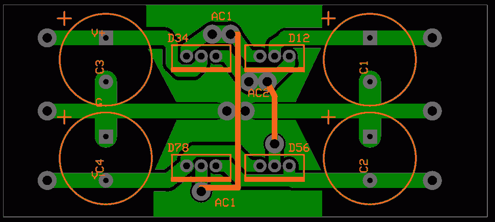

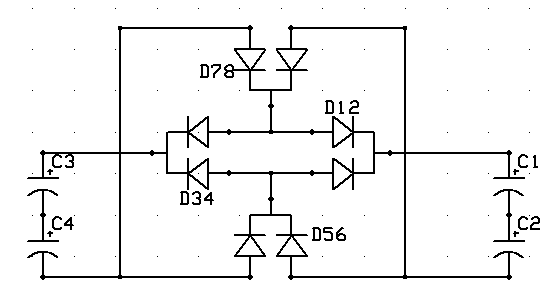

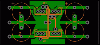

OK, I've just drawn a dual rectifier + filter caps PCB in ExpressPCB.
The rectifiers are some ST STPS20150C in a TO-220FP package.
http://www.st.com/stonline/products/literature/ds/7756.pdf
If possible, I'd like someone to check if the layout is OK, especially the ground plane. No need to take time to follow all the traces one by one, just needs a general check, as I'll put a regulator and other stuff on one of the outputs.
