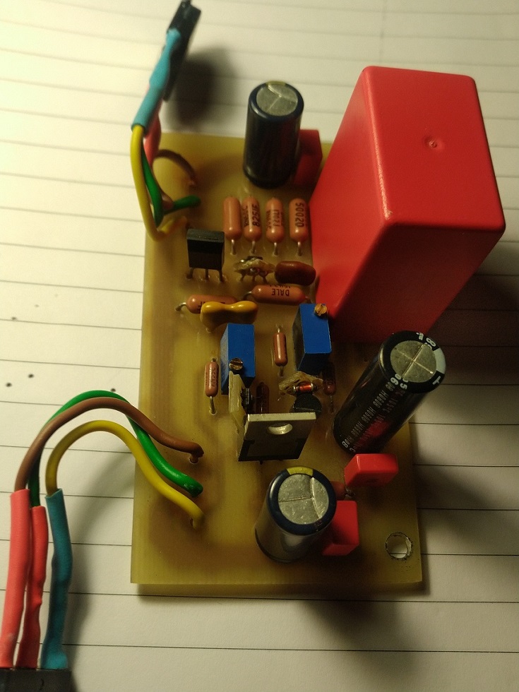

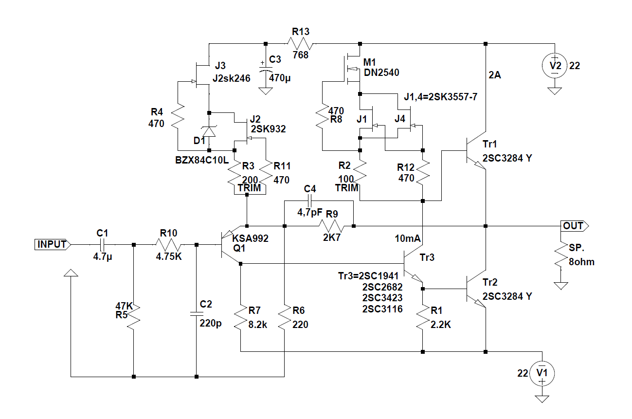

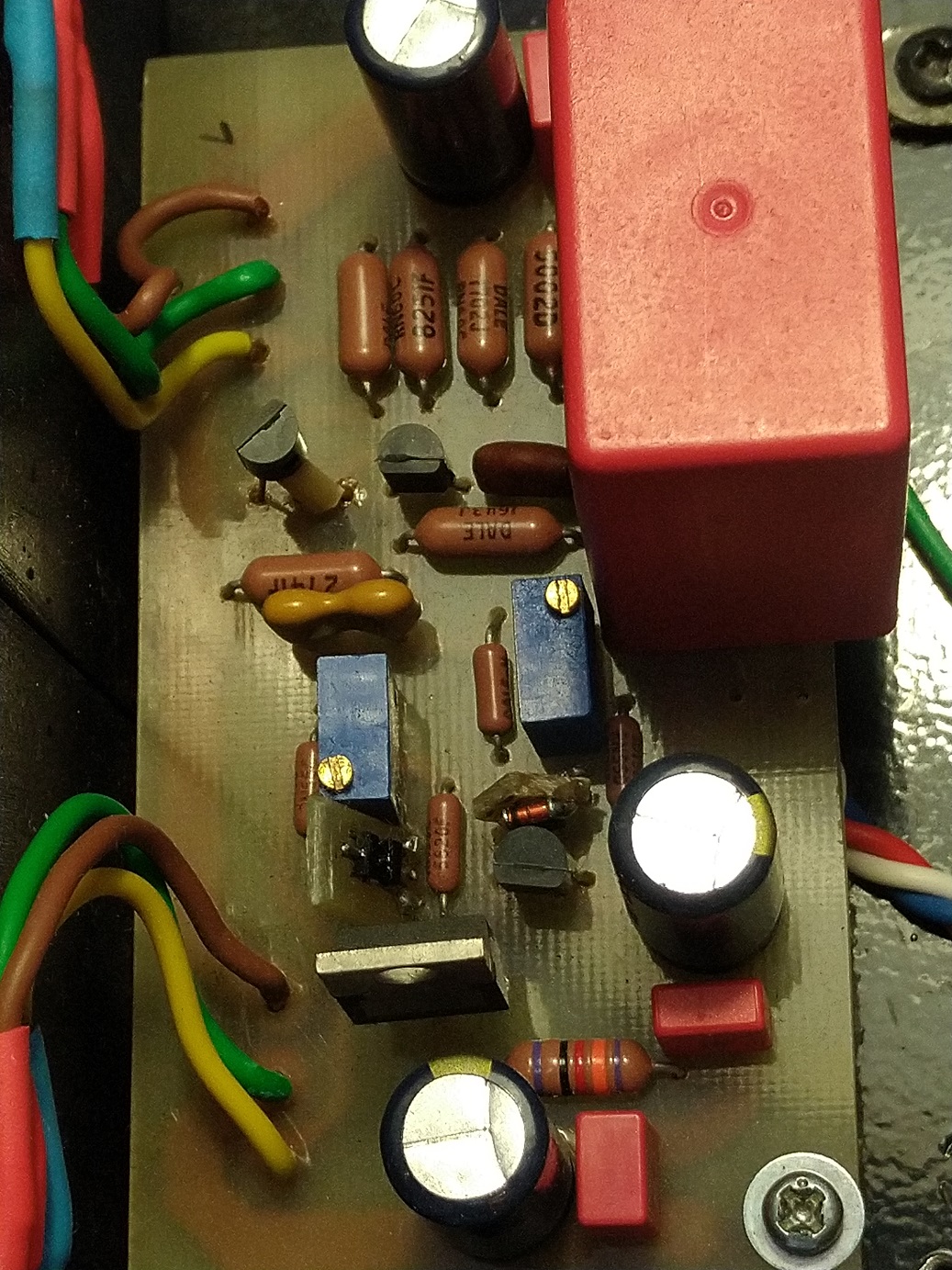

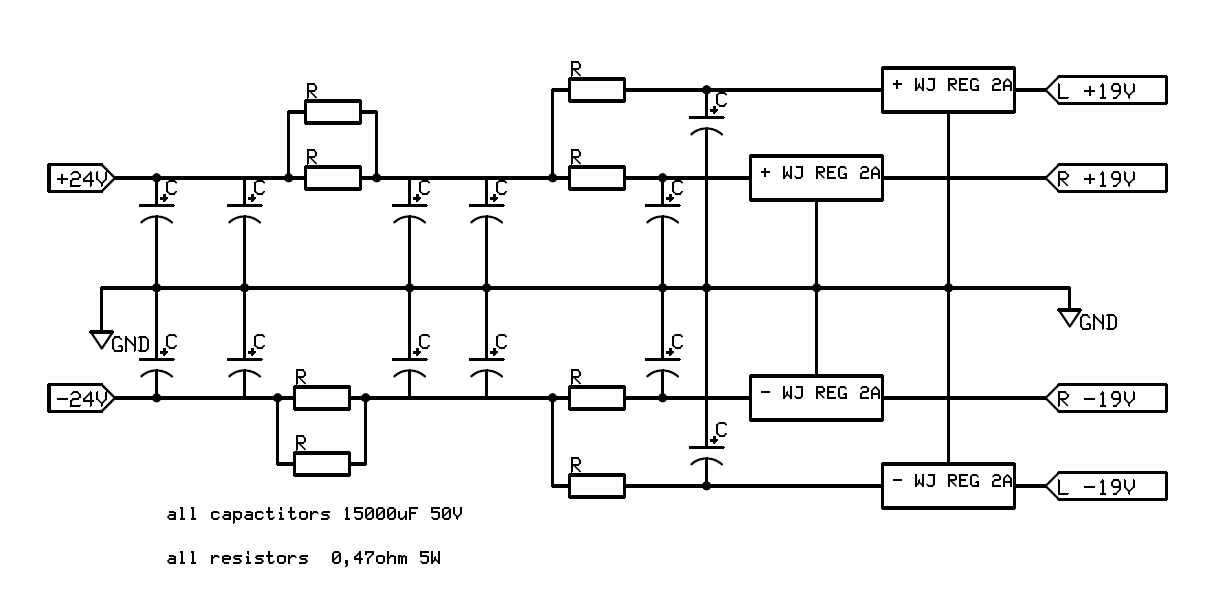

I also upgraded both CCS with jfets and DN2540, and I did an extensive driver transistor test and found the best .
It has also been upgraded with 2A walt jung style superregulators for + and - supply.
I intend to try using Hifisonix Ripple-eater. I know you also have used capacitance multiplier. At present I use +/-18V toroidal transformer and I end up with a bit more than +/-24VDC. Capacitance multiplier (ripple eater) would result in optimal +/-22 VDC. Your thought on that subject?

You can install an additional filter (passive or active) in the (+) rail between the collector of the output transistor and the driver resistor. This will reduce ripple and give a smooth start.
Gents, a very good option is the MJ802. They are 30 Amp 100 V devices and very rugged. Recommended by Geoff Moss himself, on TCAAS. I have used them for many years with no issue.

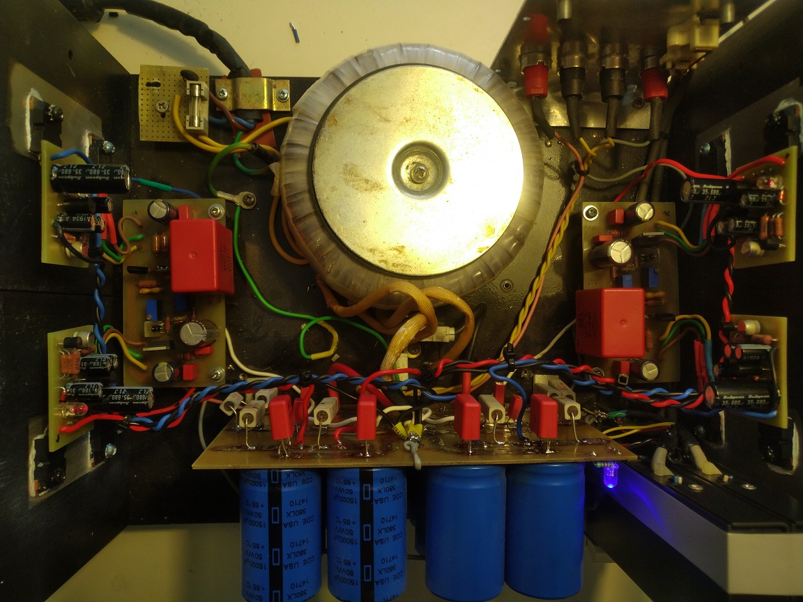

Sharing my experience building this a couple of times. My goal is to manage the heat from having the bias at 4A at dual 24VDC to drive Martin Logan ESL panels. I ended up using a rack mount industrial power supply that I retrofitted couple of quiet cooling fans with. I did remotely locate the supply using the sense lines. That removed a huge source of heat from the amp.
As far as power devices, I used TO3 devices I pulled from a couple of Krell amp boards, thinking they are sorted and matched. I used their OEM labeled MJ15024 and 2SC3281. Did not have issues with either type.

I did end up having to fan cool the amp itself. My heatsink was sized for 2A and +/- 19V but the amp clipped into the ESL so I bumped up the supply voltages and the bias current.
I think Krell sourced all their TO3 devices from Motorola/ON. The current distribution in either the MJ15024 and 484081 (Krell version of 2SC3281) types are quite even.

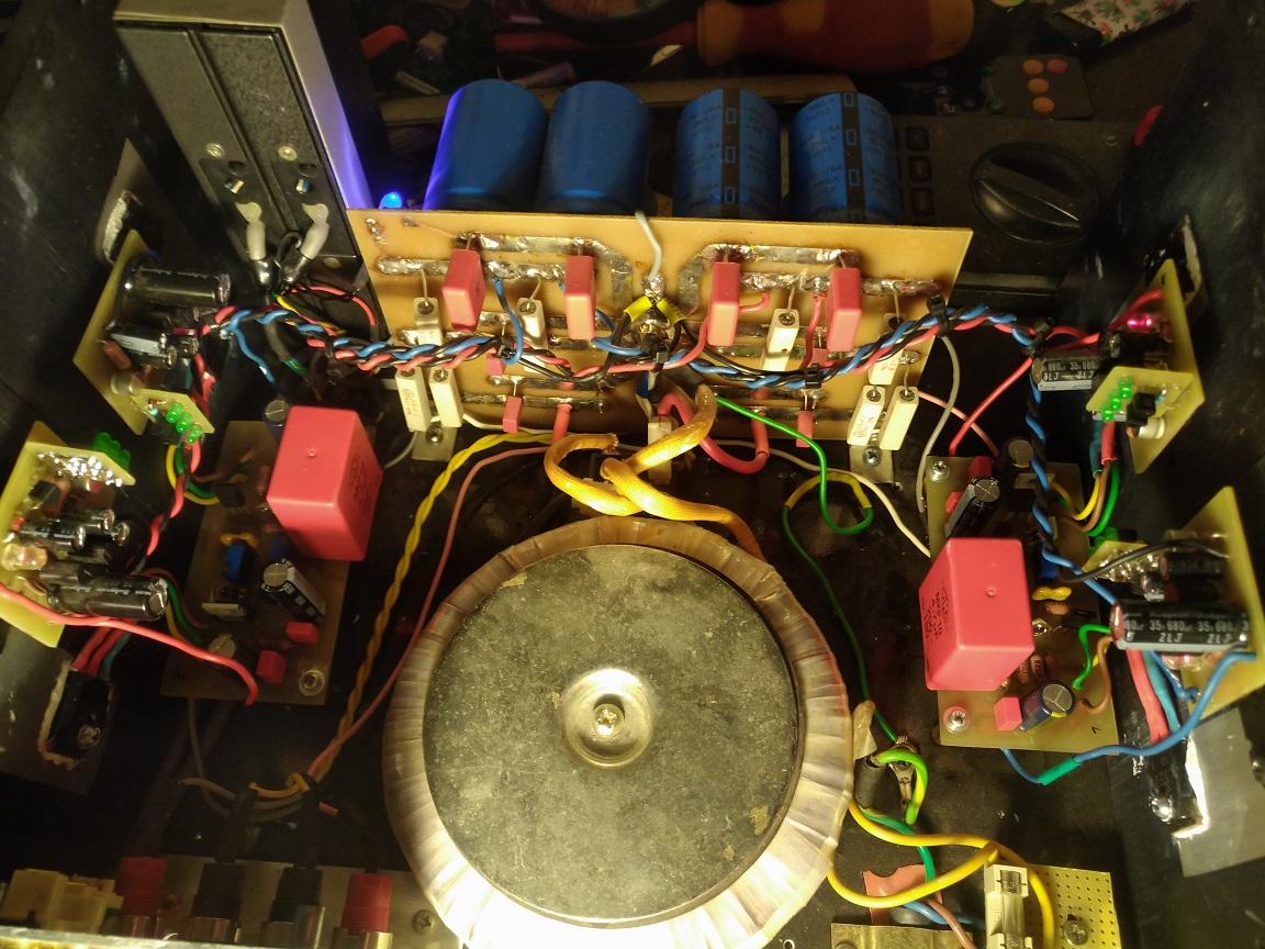

This weekend I brought my JLH back to life, the last six months in its place was Le Monstre.
Nothing has been done on it at the moment, but I recently upgraded the regulators while Le Monstre was still in the box.
The sound is great, beautiful .... Really great amp !!
But all this took time and effort to find the right combination of power supply and parts used in the amplifier.
Le Monstre is also a great amp, but JLH performs better at lower frequencies.
My recommendation is definitely a good regulator and before it as much as possible to reduce the ripple in the voltage, I got a great result with a CRCRC filter. I have about 2V voltage drop on the filter and another 3V on the regulator.
