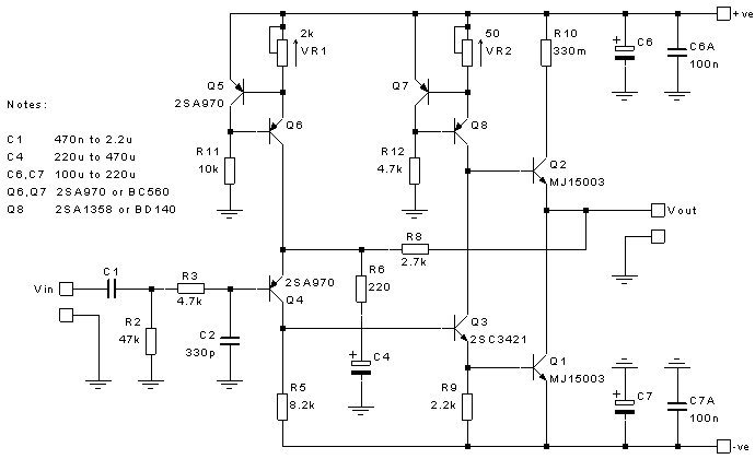

What is JLH Class A Penultimate version?
Here it is:

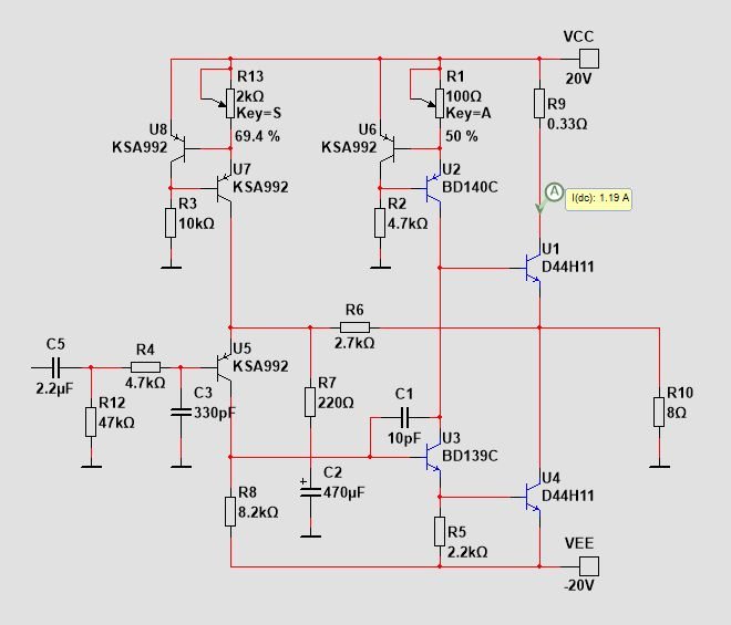

I will show my version with more common transistors.
All for to have the lowest distortion.
Here it is:
